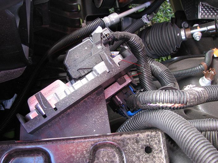

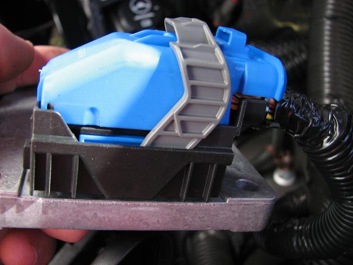

The tranny does have an external controller. It is located on the same bracket as the ECU in the left front corner of the engine bay and has its own plug-in. I have a picture of one attached so you can see what I am talking about. The ECM has several transmission references – Park/Neutral, brake, VSS, VSS High, and VSS Low, but no control. So far no BCM interface requirement.
The engine controller is indeed an E38. So far the only issue I don’t have figured out is adapting the cruise control in my truck to the DBW. My wife is saying forget the swap in the old truck and just swap it in a NNBS. I am a bit reluctant to go for the new truck because I am planning to buy a new Z06 in January. I don’t think I can do both. I will keep you updated.
Sorry, the original pictures were too large.
I don't see a pic attached? Thanks for the info, hoping my 07 will be easy drop in (tranny or both) when the time comes....new Z06?...nice!!
