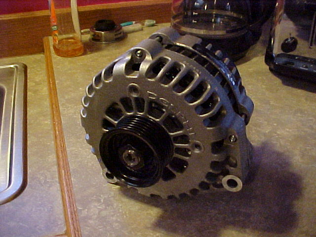

Ok I just got the new generator,
The pulley is the same size but if you line up the mounting holes with the 105 a it sits approx 3/8 higher.
I called ASP and they have a listing for a belt 1/2 longer gates KO6O900
This belt happens to be the belt for the crank and bigger alt pulley kit so it makes sense.
I'm going to try the belt I have on there now first. I have the ud crank pulley belt.
Does Goodyear make the gator belts for our trucks with the ud pulley?
