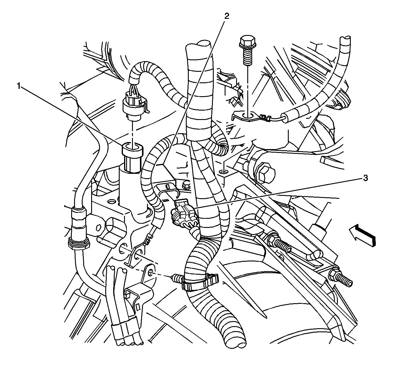

ok, did some quick checking, coils 1/3/5/7 get power from INJ 1 fuse, coils 2/4/6/8 get power from INJ 2 fuse, pin D on all coil connectors is ign. power (pink wire), pin A on all coils is ground (black wire). check the coil grounds for resistance and check the fuses. the coil ground goes on the driver side of the engine on the same bolt as the negative battery cable.

heres the diagram for the grounds on the rear of the engine
