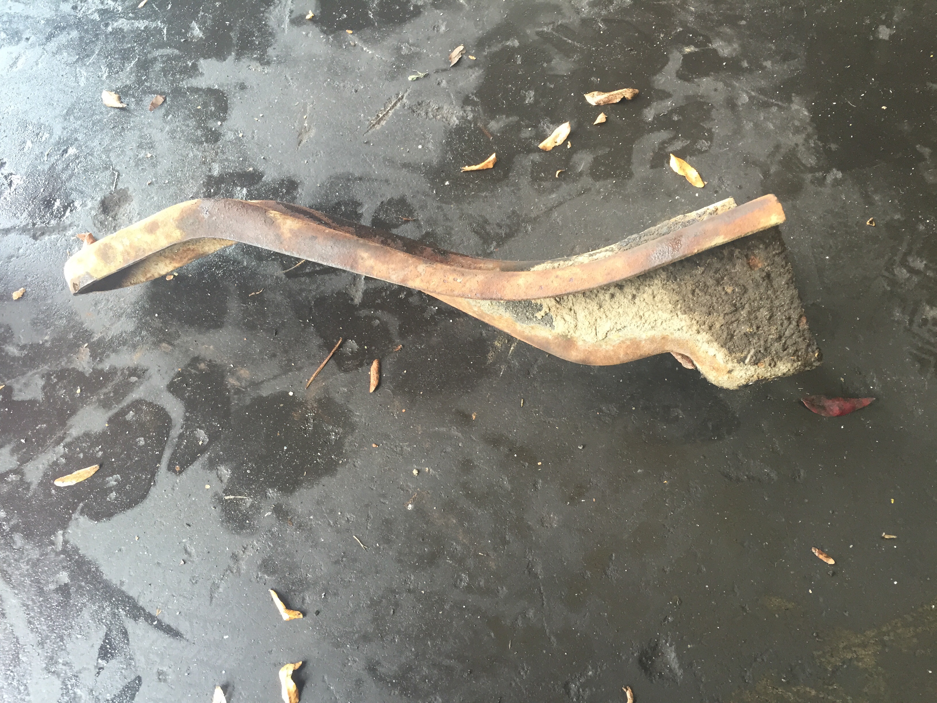

Fyi this is what that bracket i was talking about looks like right before it went in trash can!!!!
Attached Thumbnails XMSN X-member..Why is mine differnt? 60-80E swap-image.jpg

sub'd just bought a 99 Z71 ext cab for cheap with the 60e slipping. Curious how hard/easy itd be to toss a 80 in there instead
Old Sep 25, 2015 | 12:42 PM
Wolftrk99's Avatar
Joined: Jun 2013
Posts: 5,492
Likes: 48
From: Virginia Beach,VA
99 actually lookin like most direct swap.... As far as crossmember modifications go, new or modified driveshafts, wiring and tune.... And either transfer case from a truck with an 80 or new tcase input shaft to mate up.... Im sure im missing something, but thats the jest of what ive found so far!!! Havent done swap yet but with a 6" lift the rear shaft may not need to be shortened.... Have no verification on this however my slip yoke is currently out of my tailshaft by lil over 3 inches.... And thats to the hood on the seal
