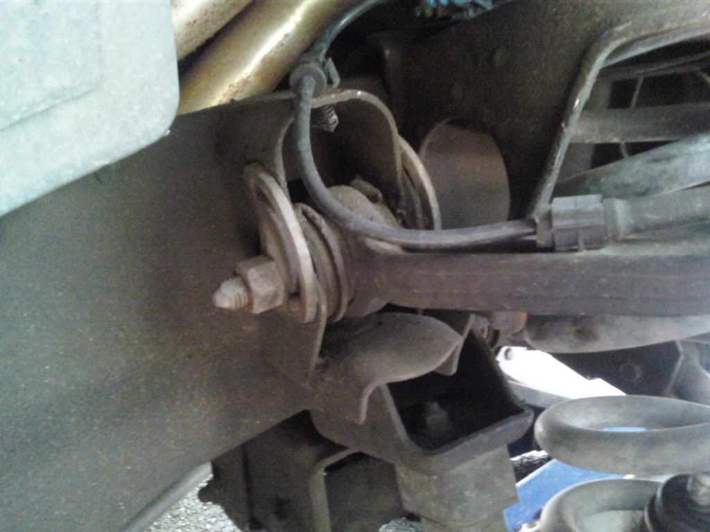

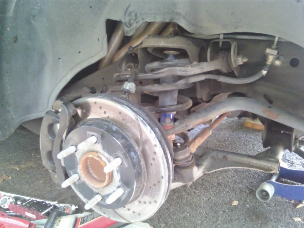

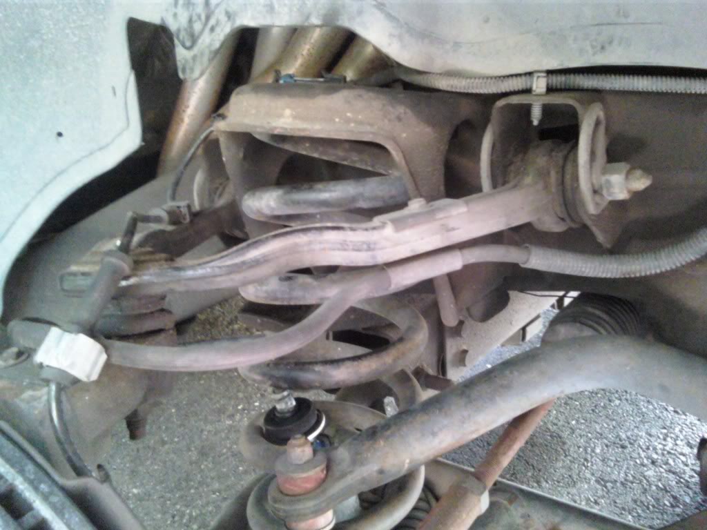

I've been trying to think of something, only thing I can come up with is the truck was wrecked before and not fixed correctly, or the camber isn't really maxed. But you say more than one shop has said it was maxed, so that takes the 2nd one out unless they are just retarded. I really don't see the springs, spindles, or control arms (other than upper and yes they would have the spec paint on them) making your camber positive. As you go lower, its that much harder to achieve any positive camber. When you lift a truck, it makes it harder to achieve negative camber. Maybe take a pic of your upper control arms so we can see if the camber really is maxed.

+1 we need pics, the shop could be retarded..
take pics of front shots of both wheels in reference to the fenders and body. Also turn the wheel and get a shot of where the control arms mount.

Im not really for sure what you wanted me to take pictures of. These where taken with my phone camera so if they are not easy to see I can get the 10MP camera. Ive had this truck since 11K miles and I got it from a dealership, so im pretty sure its never been wrecked. However, I did buy the drop used from another truck, but I do not see anything bent or anything that seems odd.

If you have positive camber on the right front, and that is what you're asking about, the alignment tech needs to go back to class. He has both adjusters maxxed out for positive camber. Any chance you could post the printout of alignment specs?
