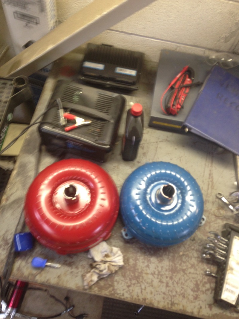

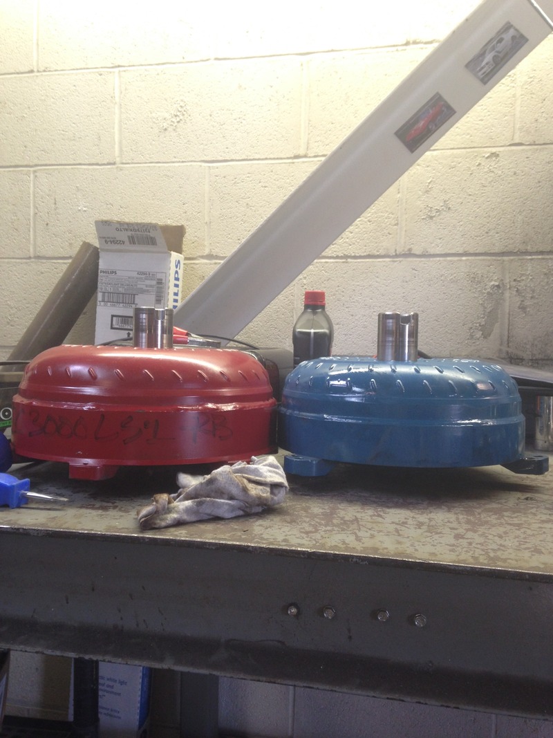

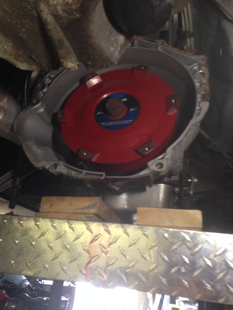

Originally Posted by AKlowriderZ71
By reading your description of the shudder, I would be looking for an ignition miss first, and looking for a lean miss second.
Who did you buy this Yank from? Any pics of the converter?
A buddy just mentioned the same thing.
I bought the converter from a member > chikn305<
The truck feels good sometimes. I mentioned to Allen that my iat's are all over the place reading under boost. Ambient starting then up to 133 then flashes 45 degrees back up to 133 in my log.
Pic of blue converter is my 3200 fuddle. Red one is the yank. Name:  C9089468-95C4-48DB-8E57-D726F09982BD.jpg
The other photo is still loading
