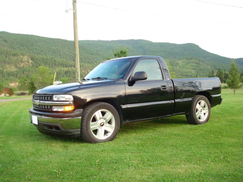

Here's mine, i just used 2500hd keys, belltech shackles, and removed the rear block... i havent had any pinion problems, and it rides the same or better than stock.

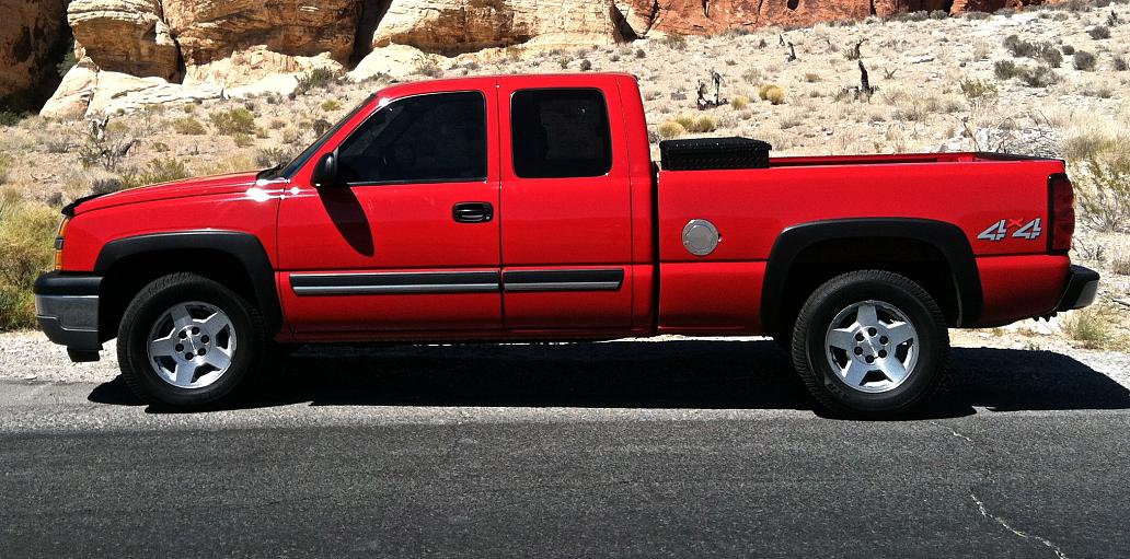

Im looking for a mild drop, im going to take the suspension blocks out of the rear to start then looking to possibly do 3in shackles in the rear then 2in in the front. Any cheap ideas??
