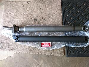

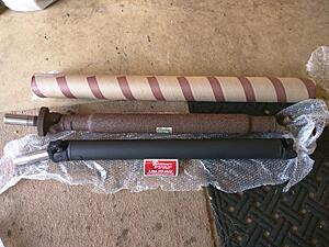

Here are some pics of the new driveshaft compared to the rusted stock, and modded eBay stock I tried first. It's steel fwiw.
