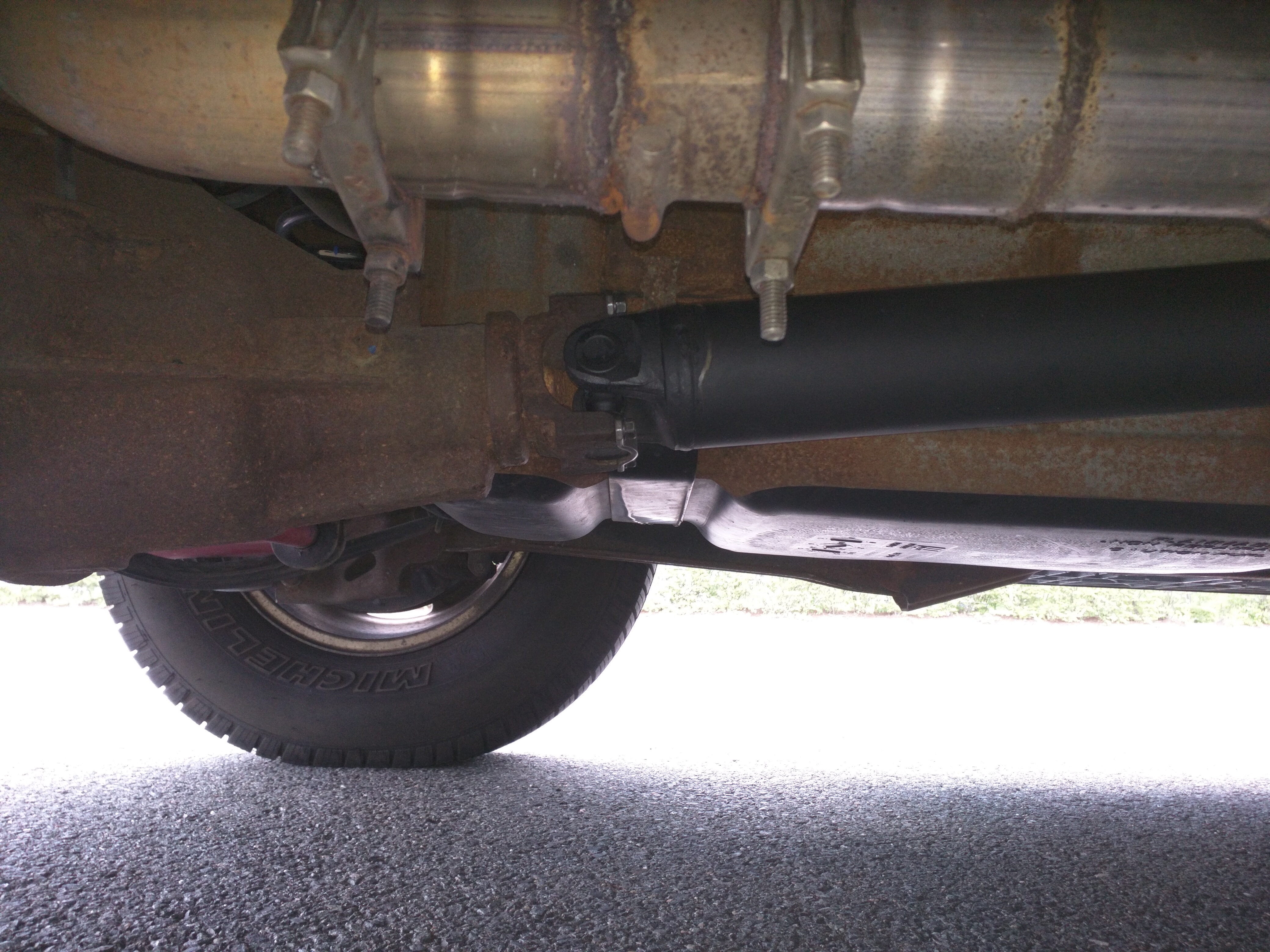

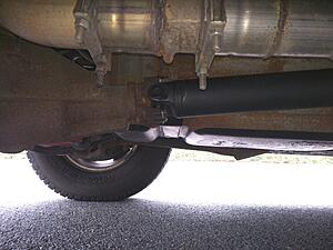

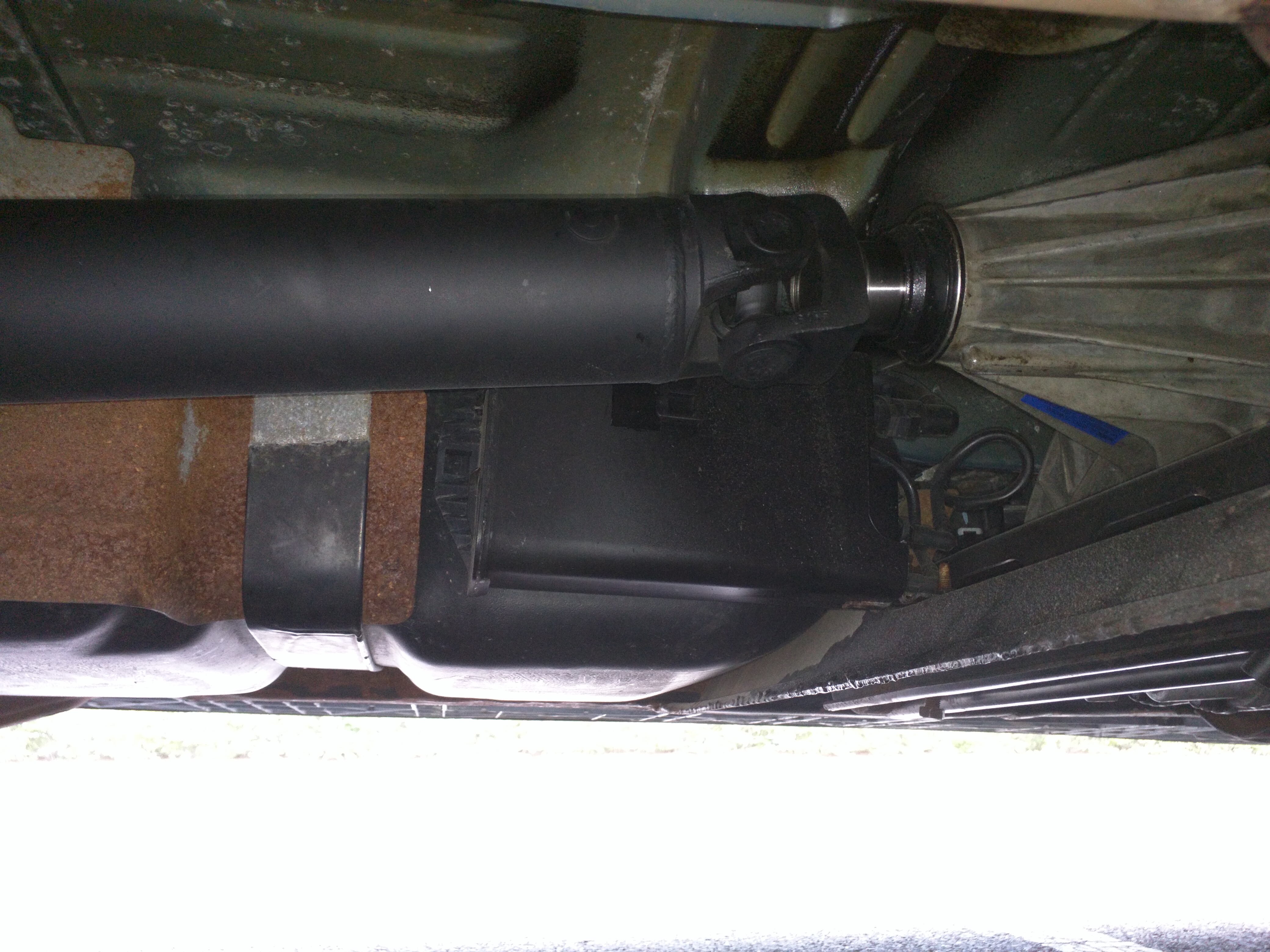

I still have vibration after raising trans up 6/10 inch. Keep going up? Any thoughts?
Old Jul 25, 2016 | 04:41 PM
tgui's Avatar
Joined: May 2014
Posts: 1,252
Likes: 7
From: VA
Pics
