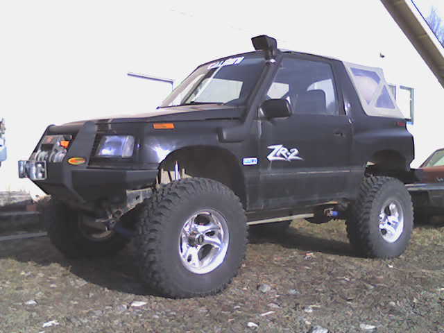

Also, go 33's instead of 31's. You'll want them for the extra clearance to the diffs in the mud.
Here's one of my old off-road projects. It went everywhere (mud, snow, mountains, swamps), and still had open diffs when I sold it. Locked rear and LS front would have made it unstoppable!
