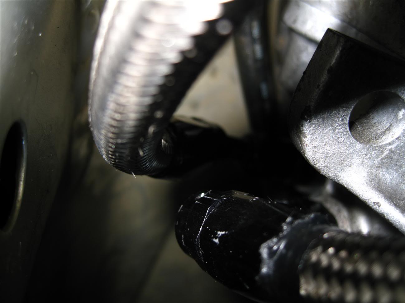

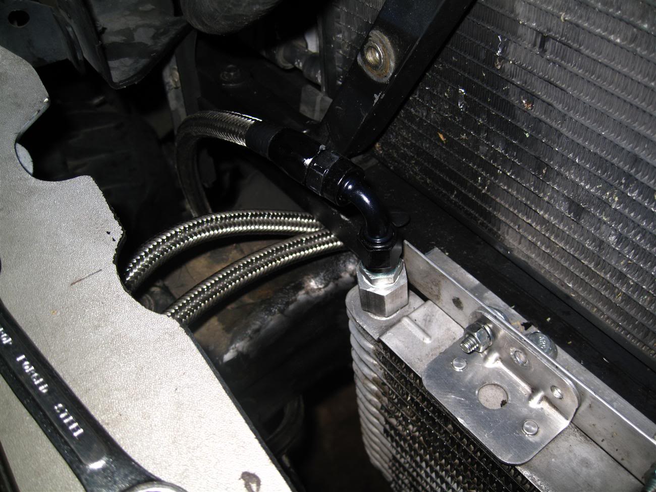

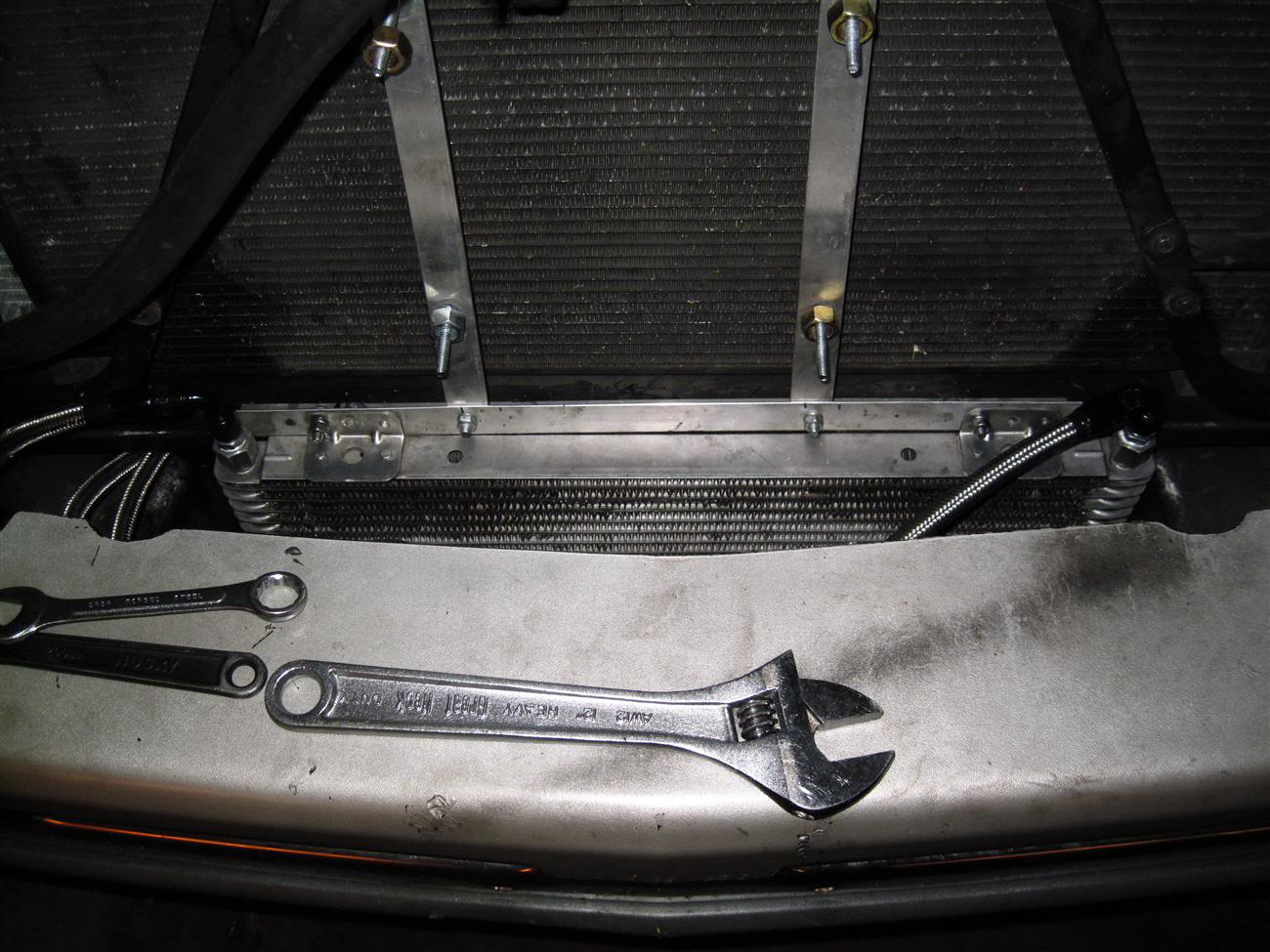

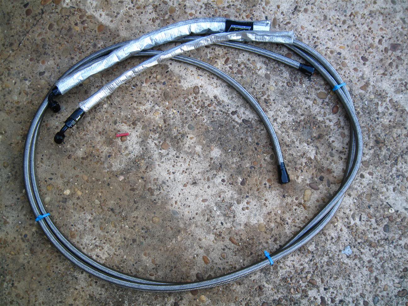

Finished today using the list I posted earlier in the thread. I made two lengths of about 8 feet so I have 4ft of extra if I need it for anything. I also have enough slack where I can use this on an 80e if I need to. AN hose fittings are tricky if you have never done it before. And getting to those trans fittings was a tight fit for sure.

Looks good Atomic, nice job
