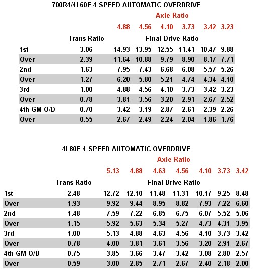

Originally Posted by thunder550
James - what does the gearvendors thing do?...
It's another overdrive. It has a self-contained pump and lube system with a planetary gearset, conical clutch, overrun clutch, and one-way roller clutch. It has a 22% overdrive ratio, or 0.78:1 when engaged. The Gear Vendors widens the overall range of gear ratios you have and lets you run lower gearing in the differential than you could overwise have without it.
Take a look at this CHART
Stock, it had 3.73 gears and a 4L60-E. I now run 4.56:1 gears, a 4L80-E, and the GV Overdrive. It almost completely makes up the difference in range between the 60 and 80, and it gives you the closer ratios of having 5 speeds over nearly the same overall range the 60 only gives you 4 in. (You know that annoying RPM falloff in the 1-2 shift on the 60? Not so with an 80.) It is possible to split every gear with it but that's just a hassle. It's perfect for the highway. Just keep in mind that with a combination like this you are running power through FOUR planetary gear sets (five with 4WD) and two pumps. This doesn't come without at least some penalty in driveline power loss.

Wow - looks cool, wish it wasn't so expensive though. Does it handle loads of torque?

Ya, the GV are really tough units. Will handle a lot of torque. I used to install them in motor homes and truck alot when I worked at Camping World. But they aren't cheep $2800 for the GV plus gears front and back plus all the crap for an 80 conversion I'd be looking at close to 8K That's a lot of coin!! I'd need to run about 20 psi of boost just to make up for it
