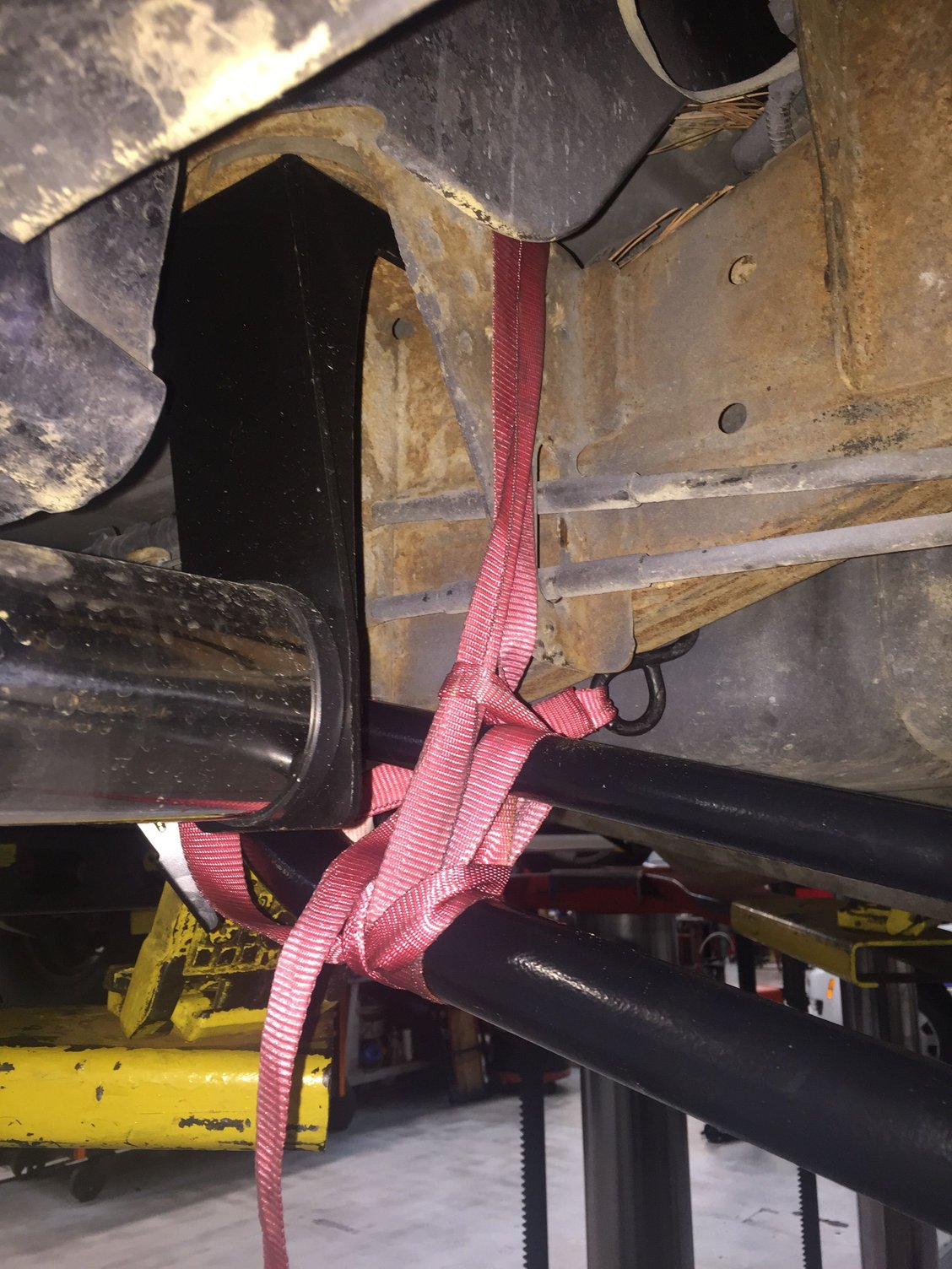

Well made progress tonight....got bars in, sort of....ran out of time, so i didnt have a chance to drill through the frame and still had to get the truck out of the bay at work, soooo..... I did what any good redneck with a lifted truck would do, i ratchet strapepd the front of the bars to the frame and eased around the parking lot to park the truck
With both add a leafs in and the new 5" blocks the rear of the truck sits at 46.25 on right side and 46.375 on the left side.... And as far as i could tell my tires dont rub my damn fender anymore on sharp turns...
My makeshift frane mount....

:lol been there done that. What lift kit and tire size you running? You got pine needles all up in your truck lol
