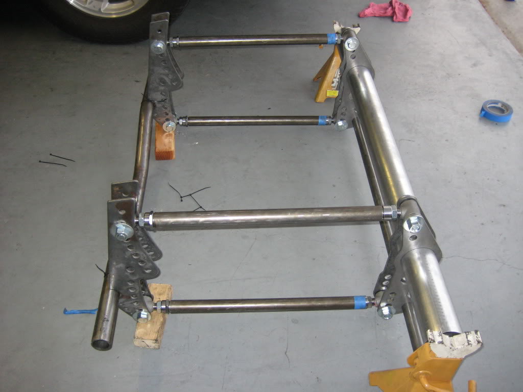

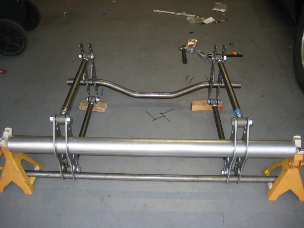

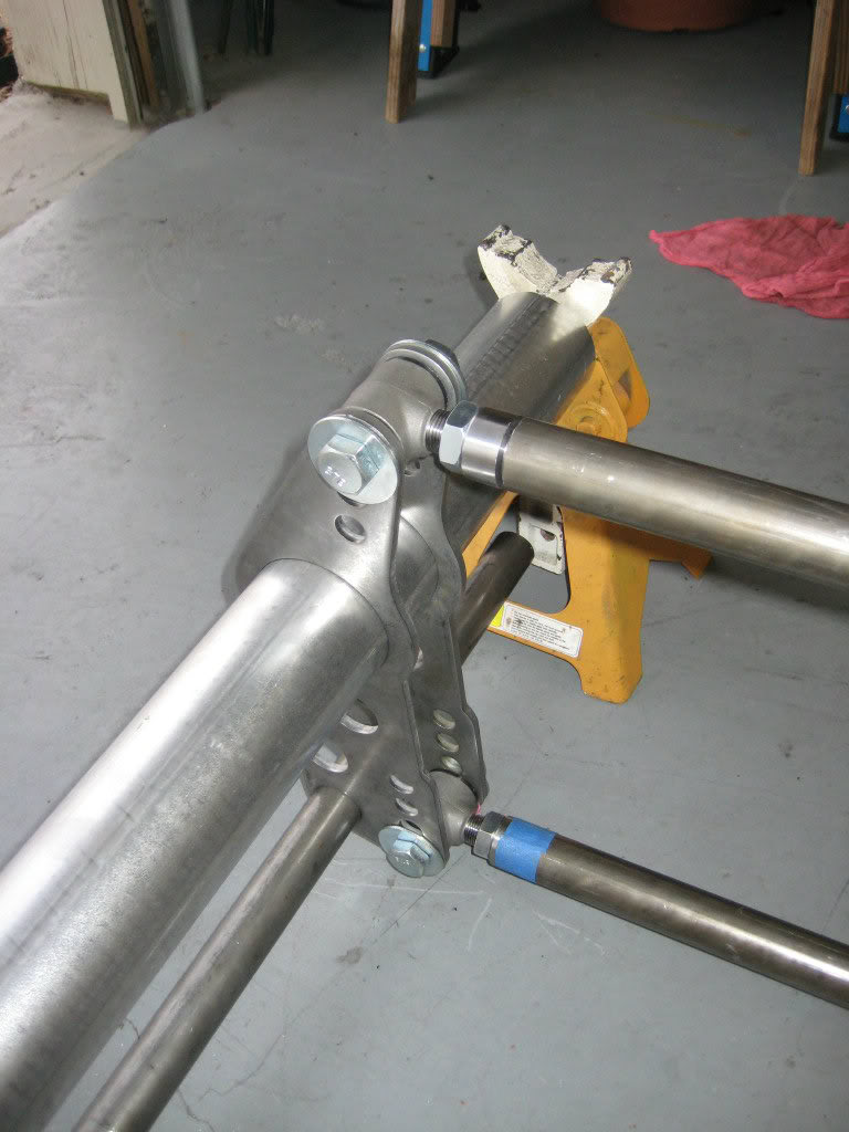

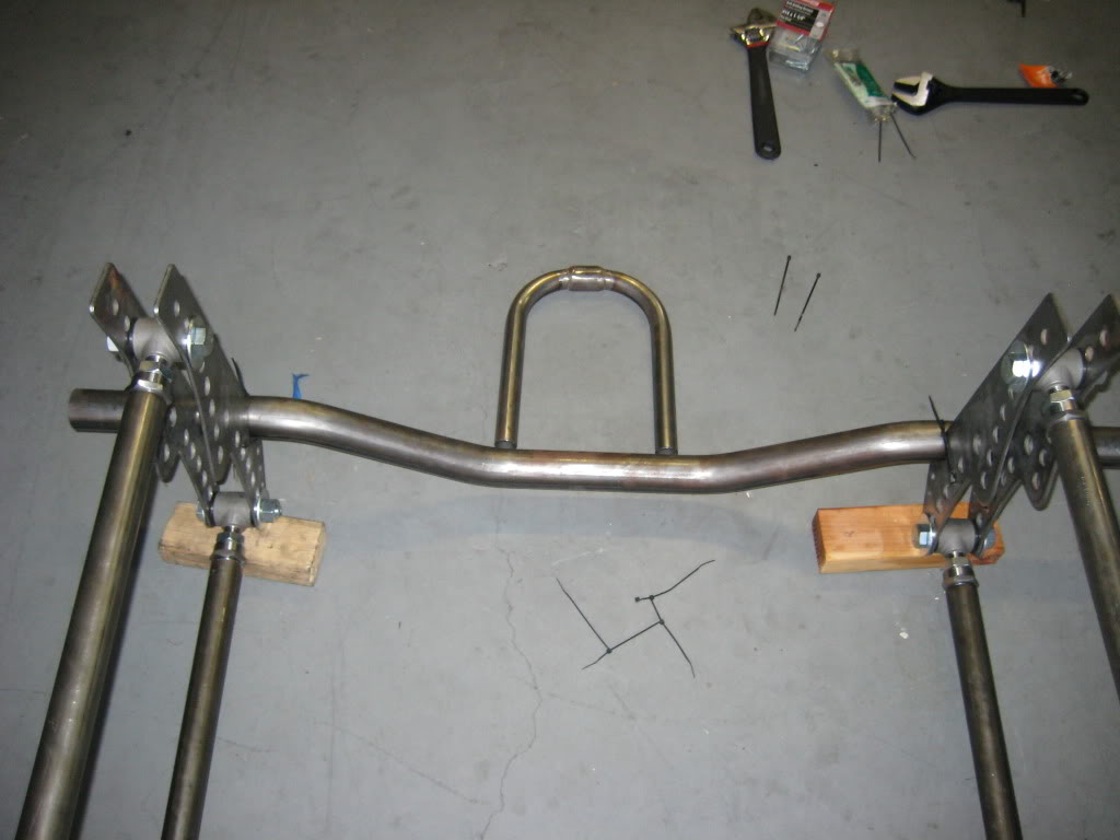

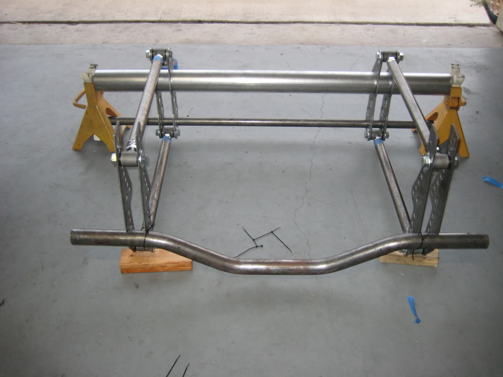

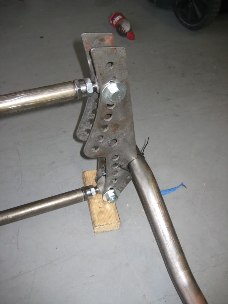

More to come.... I am still in the planning stages...

Fn sweet man , takes ***** to do a project like that, Id be nervous haha.
Awesome !

Thanks man... It took 1 hour to setup at that pic... With those tube not welded to the adapters everything kept slipping apart... i was bound and determined!

Looks good. Any reason why you didn't go with a triangulated 4 link, so you could have got away with out running a bar?

I dunno. Never thought about that. This seems simplier to setup at least to me.

Everything about the geometry of a triangulated 4 link is just wrong! He'll probably run a track bar which will keep everything nice a square with no bind or side to side movement.

yep i am planning on running a diagonal link setup... i would love to do a watts link but with the size of the cell i ordered there is no room...
