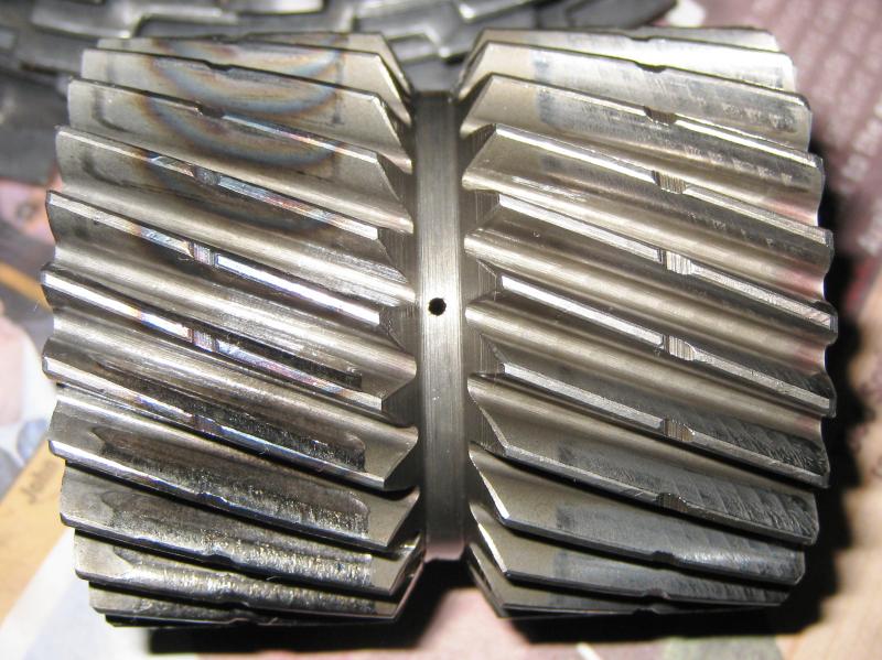

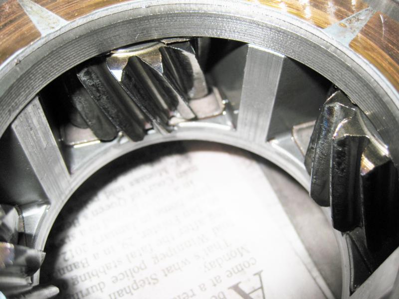

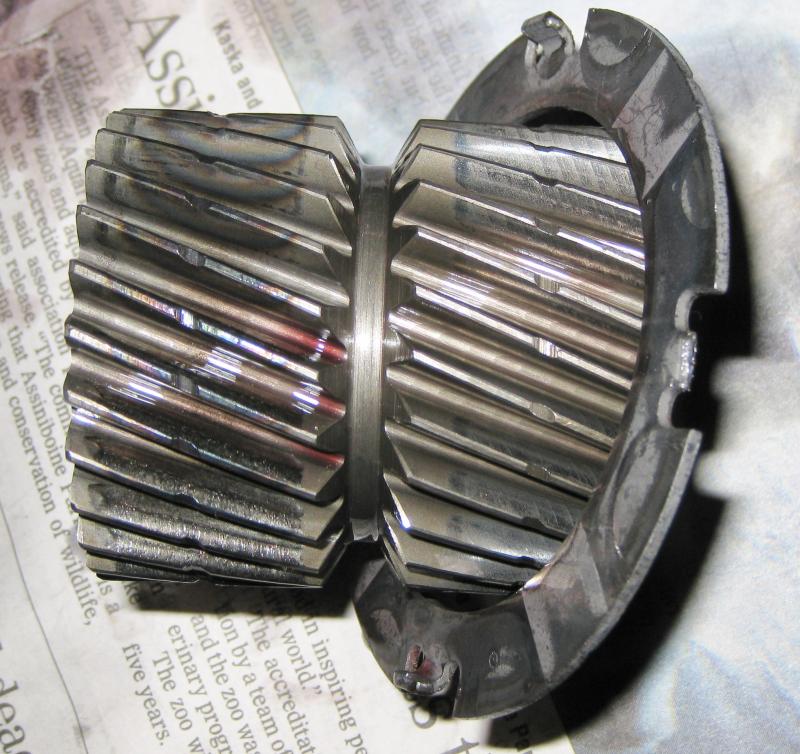

Now this one does not look so healthy....just started a teardown of a built 80E that was overheating from day 1.
Looks like a lube failure. You need to put a flowmeter on the cooler line after the cooler to see what you are getting for flow.
Do you have the extended fitting in the rear?

Flow is good. Same cooling setup(all new)/same converter/different 80E I have trouble getting it over 140*F. Will start a new thread.
