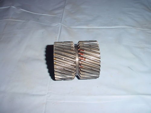

Are these grooves normal? I have 2 4l80e's and both sun gears look the same. These grooves strikes me as . If you look at the pic, the grooves don't look like they were originally machined there due to the roughness. If this groove isn't normal, can the sun gear be replaced by itself or do the Direct clutch housing (623) reaction carrier assembly (651) planetaries also have to be replaced?

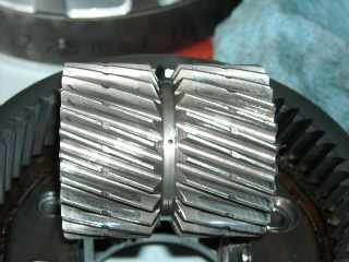

I believe it is ok for the 2005 model he has even though it's not shown on page 109 in the ATSG manual.
The first one is from a 1995 I took apart. He is afraid it should look like that
The Second image came from a 2005 assembly with the blue fabric, I stole from ebay.

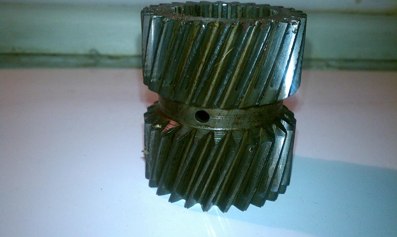

here is the best pic i have of mine. Mine is a 2001 with about 100k on it.

yes I was talking aboutthe 2 I.D. grooves and except from the first pic from 1FastBrick they all seem to match mine.

The first picture is from the old style 97 and below.
