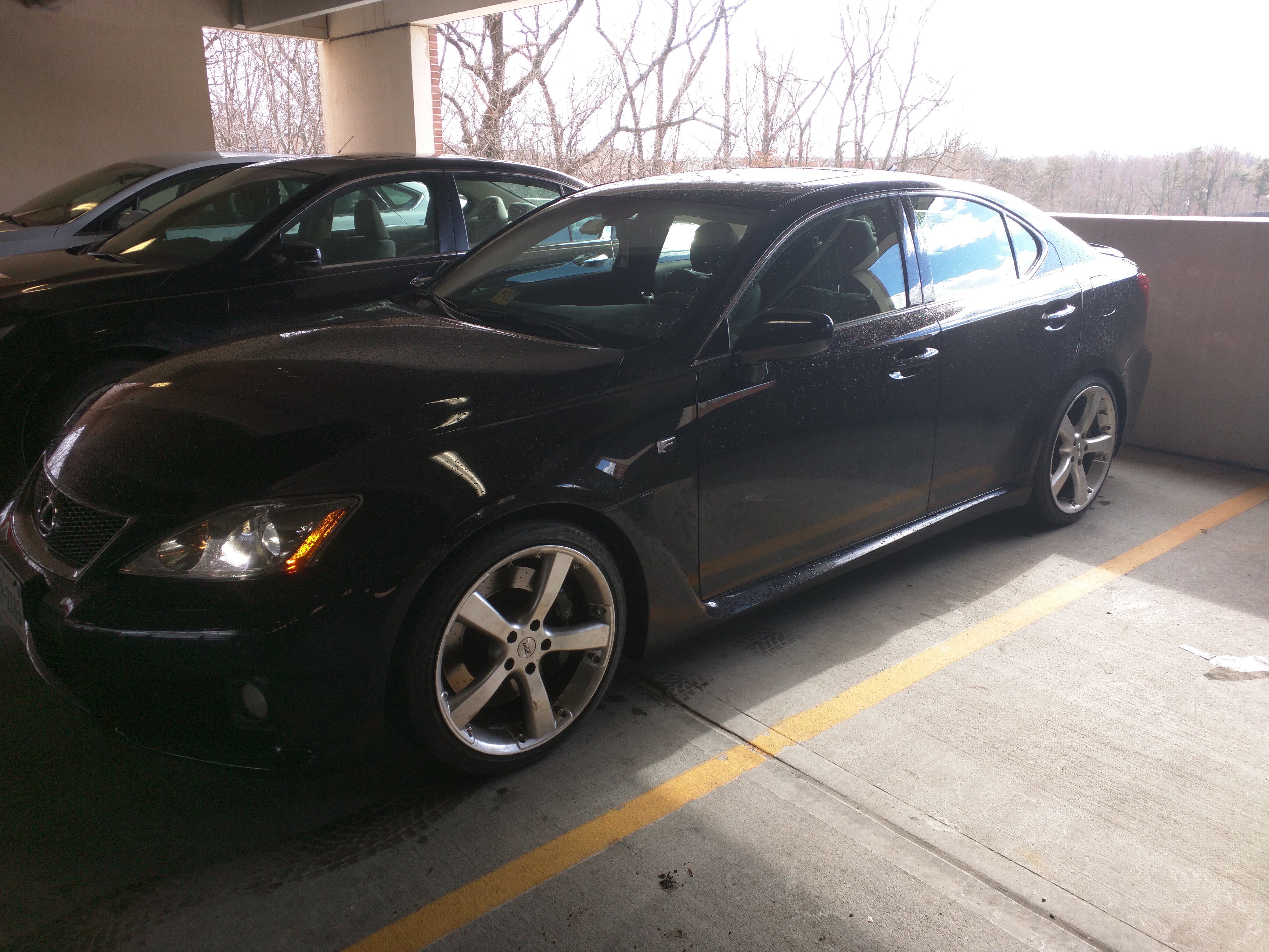

Is that your RCF. If so, the pcm has been cracked and can be tuned.
http://www.clublexus.com/forums/cl-vendor-products-for-is-f/811160-tuning-tech-fs-lexus-is-tuner.html
My ISF with cheap wheels and snow tires.
No more from me on this. I can't wait to see the dually setup!
