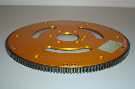

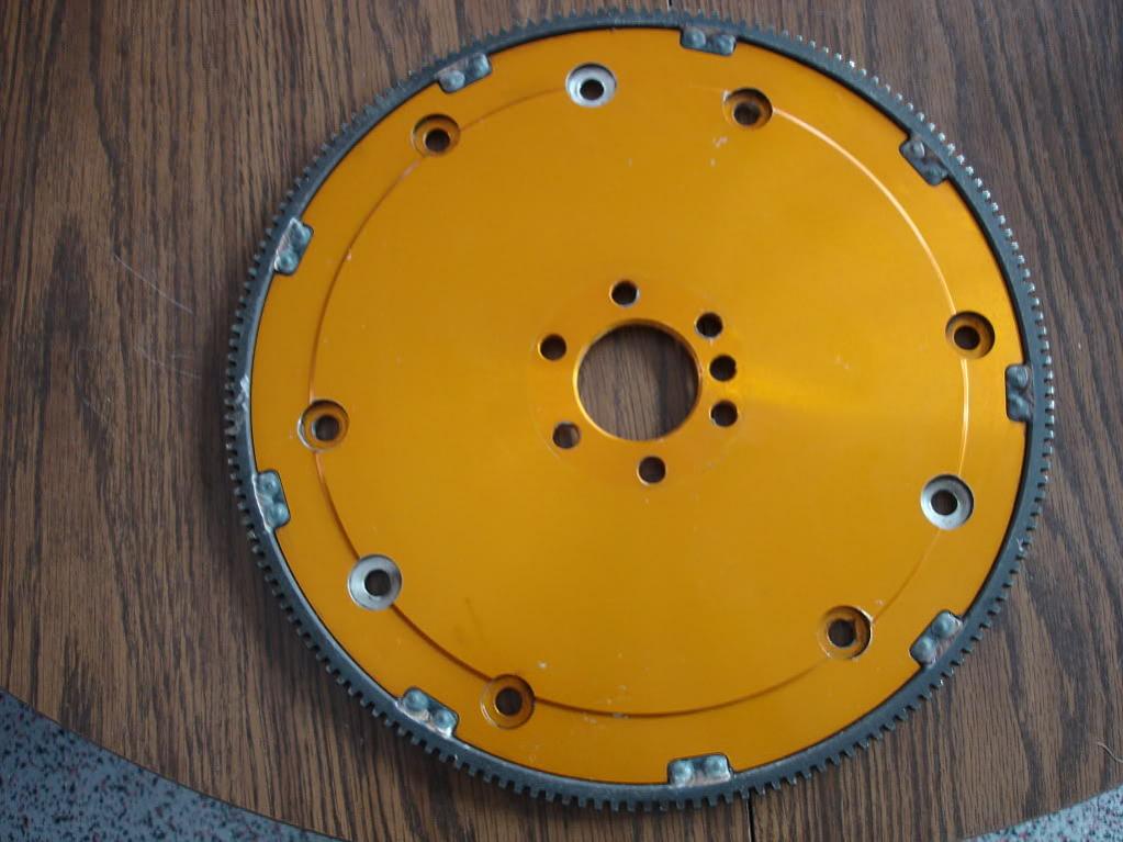

I see that the bolt holes are counter-sunk. Is there adequate space for a socket - don't want to have to use any factory style internal hex bolts.
Attached Thumbnails SFI Flexplates for 80E-coa-13621_3.jpg   SFI Flexplates for 80E-reactor1.jpg   SFI Flexplates for 80E-coa-13621_4.jpg
Old Mar 7, 2010 | 01:08 PM
Raffman's Avatar
Posts: 637
From: New York
It's been awhile, can't remember but seems like only 3 bolts lined up for the converter and no problems tightening them.
