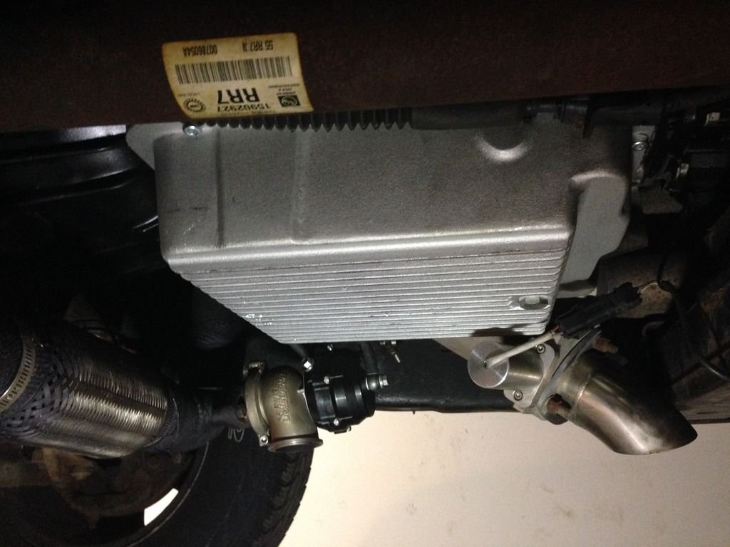

Everything works and no leaks. It def feels different from when I drove it last but I wanna say mostly from me driving my beater the last month.
It took over 3 gallons of fluid. Converter, tru cool 40k, stock cooler in radiator and the huge deep aluminum pan.
Here's some pics. You can see the pan is higher than the frame. My wg and cutout is extremely close to the pan but it all fit
