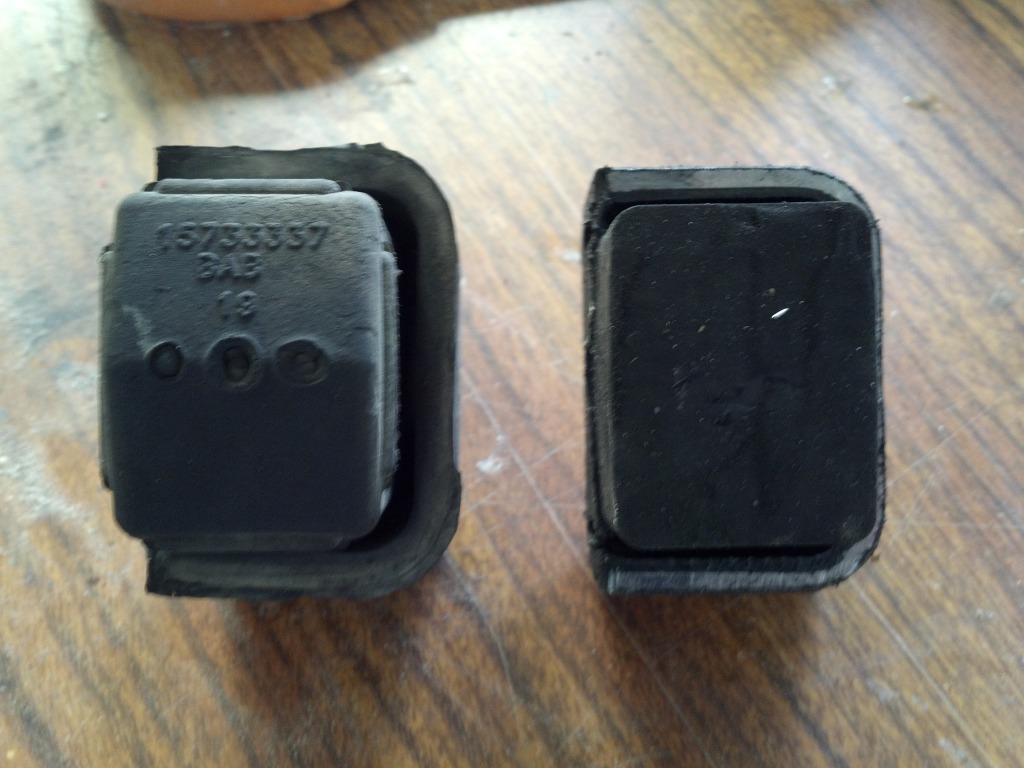

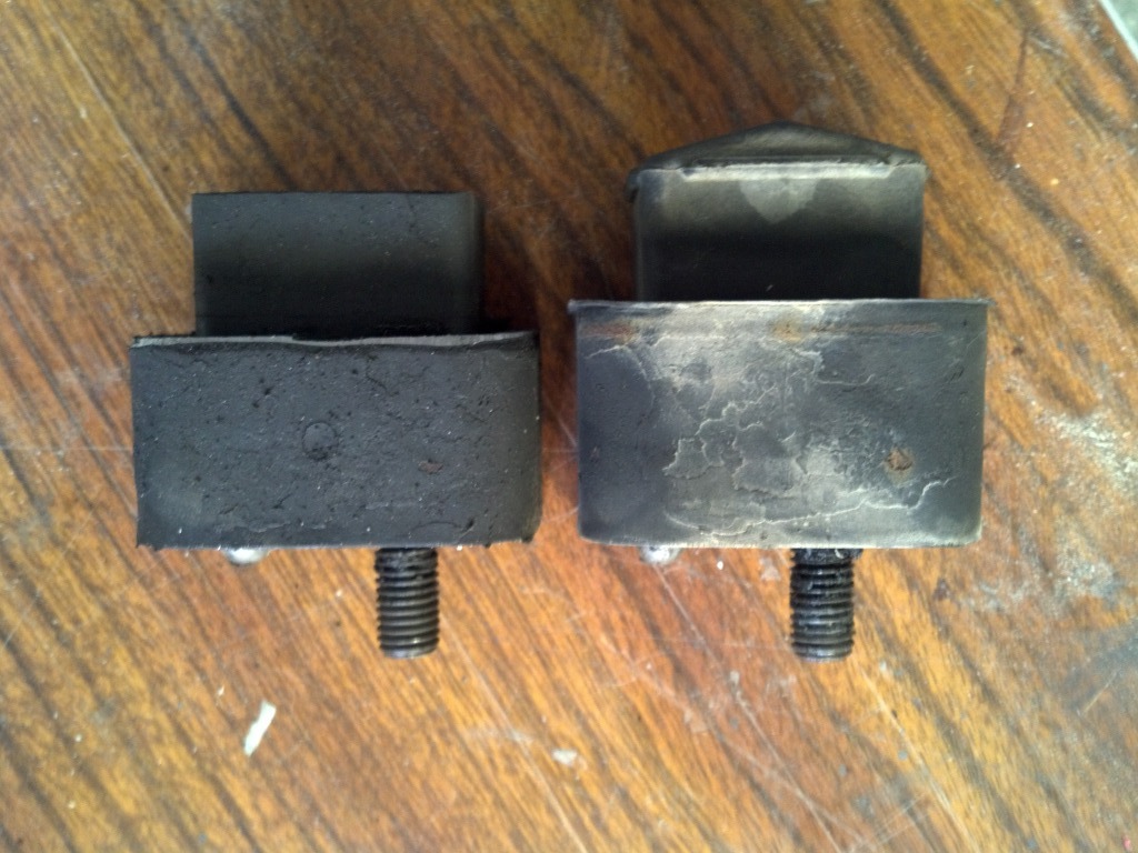

Cut my down today. I milled about 1/4" off the metal part and about the same on the rubber. Then painted the metal so it won't rust. There is now about 1/4" gap between the stop and the LCA when loaded. I didn't bother shaping the rubber into a "V". The ride is noticeably softer now in the front. I would definitely recommend this if you are dropped 2" in the front. And I think it would be almost a requirement if you're dropped more than that.

nice, can you get over all dimensions for those who may want to buy an aftermarket one? I will cut mine for now, but I'd most likely order a set from energy suspension or the like due to my disorder
