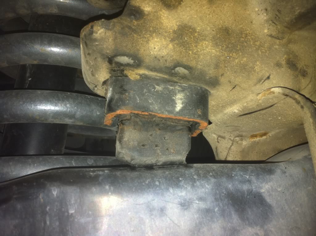

Originally Posted by black4.8
i cut mine down. rides much softer. used cut off wheel on grinder to trim the metal down. cut the v shape in the rubber w/ hacksaw and some oil. if i remember right i cut around 3/4-1" off.
Same thing here. Name:  a0ef3d03.jpg
Still need to "v" the rubber part for progressiveness. Before, I could feel the control arm hit the steel part of the stop with 3" coils.

So this is from a buddies 01, anyone foresee an issue running it over trimming?
Old Sep 9, 2012 | 10:05 PM
wheeliE-maxx's Avatar
Joined: Jul 2008
Posts: 376
From: Kemah, tx
No progression, probably stiff. Just trim yours mane.
That's a rear bump stop, way too short for the front.

No, that was from his front I believe 99-01 was different.
Found these
Prothane 19-1312 Prothane Universal Bump Stops
http://www.jegs.com/i/Energy-Suspens...rentProductId=
