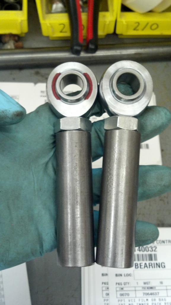

I've looked into heims for the tie-rods looks bad *** would definitely do that.
To do uni-***** wouldn't you have to custom fab new control arms? or is there a kit already made?

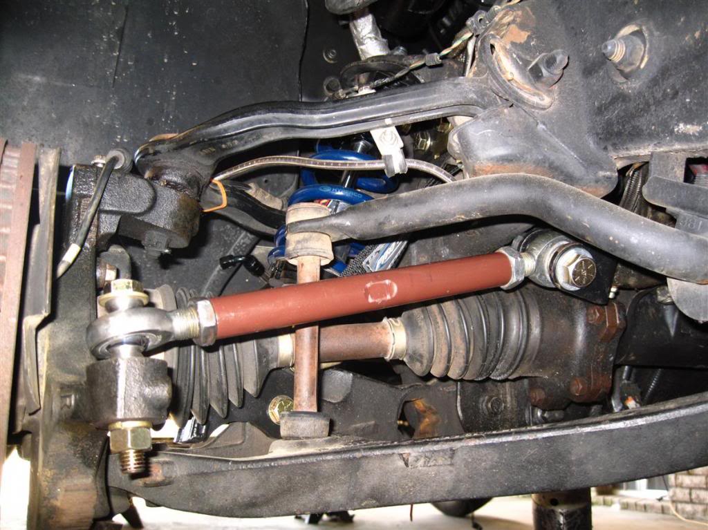

Heims? You mean like this?

What's the setup for the inners on yours like? would it be the same for 2wd?

Center bolt screws into the centerlink and the heim attaches to the bracket. I think mine are an old cognito kit, but there is a guy on GMFS that sells full kits for a good price. Should work on 2wd...

Correct Atomic. Ffr has inner and outer. He's on gmfs. I may go with his or Brett's tukn4s
