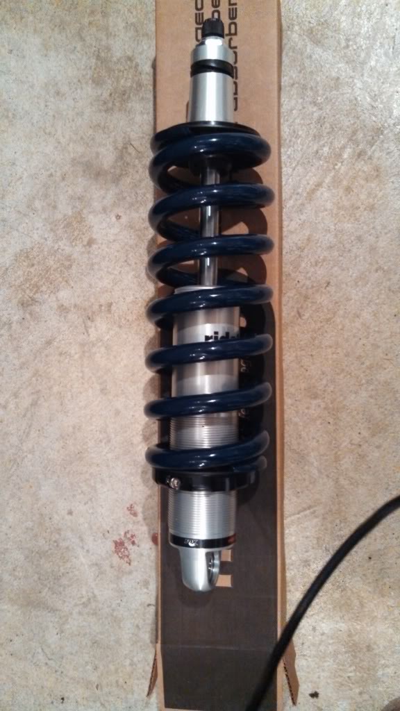

Well, got my coilovers....
Unfortunately for me, when bolted up in my current mounts with this spring length, the lower spring perch rubs the outer CV Boot. Kind of expected it though.
Looks like I'll have to look into custom mounts pushed further back... and probably just raise my UCA mounts at the same time.
