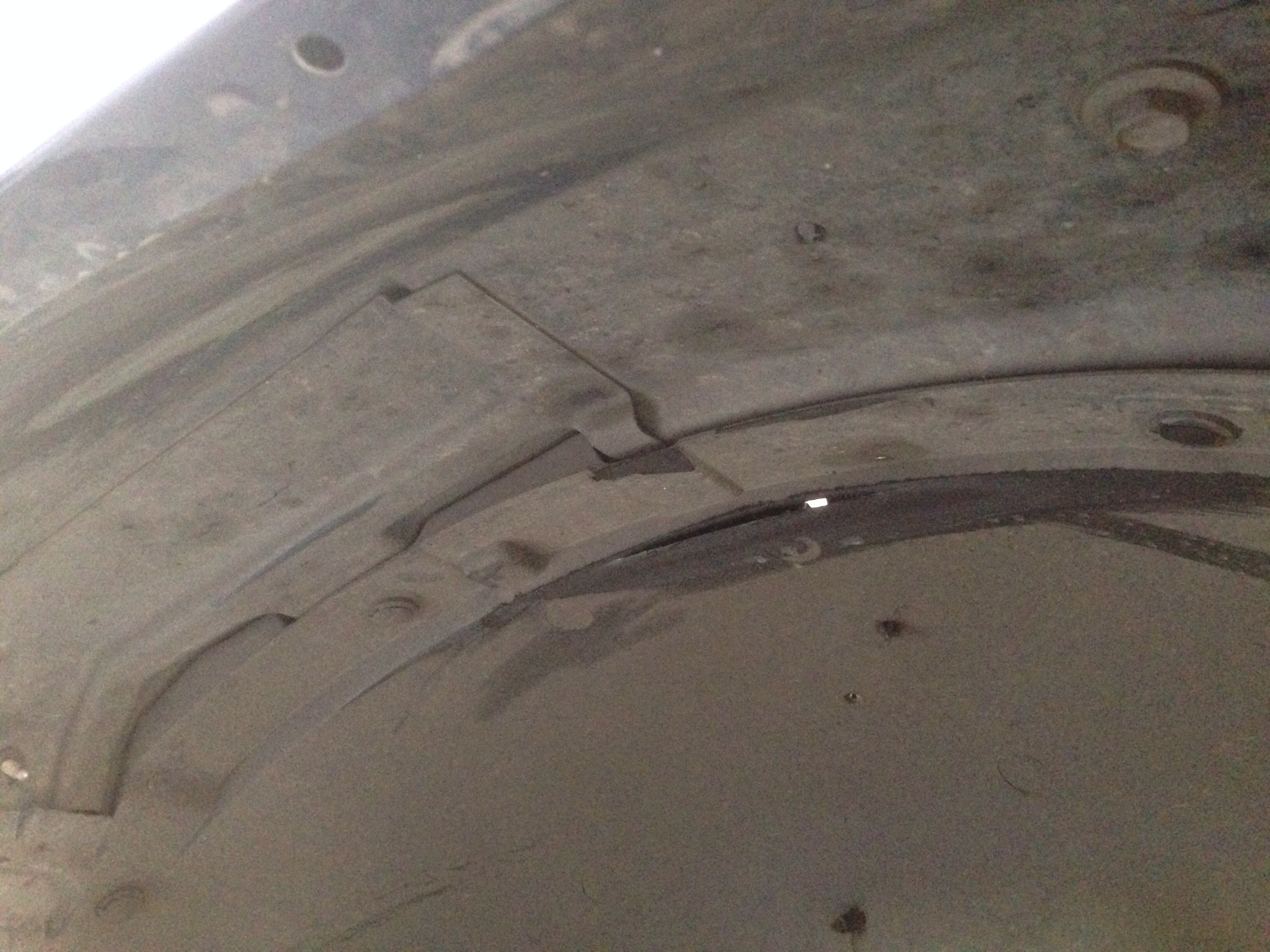

TheBeeblebrox do you have a problem with ture rubbing? my truck only has 2" lowering springs on it and I noticed thers is rubber marks from the tire hitting the fender well since I swapped out the bump stops for shorter pair

Yes it will rub when I take corners hard, so ever other day for me haha, rubs at the very top and just inside the fender, I will eventually do a mini-tub or full tub.
