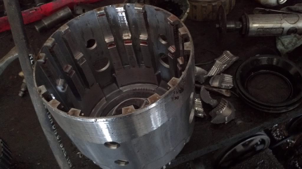

Transmission is back together, thats what broke, mecanic said everything else looks good, any idea why that part would break? Sorry i dont have a name for it

You broke the input drum. I personally like to install a sleeve kit in these units when I build them to reduce these type of failures.

The sleeve Kit Vince is refereeing to is made by Sonnax. It's known as "Input drum Reinforcement Kit". It runs about $50-$60
It involves a stainless ring and a modified old style overrun piston and seal. It helps prevent the failure shown above.

Well the kit I use is similar but does not use the factory over run piston. I designed a billet piston that relocates the outer lip seal and it just works. If you use the kit from sonnax you should add their billet forward piston so you do not have over run clutch seal failures when using a factory steel bonded piston. You could use the factory aluminum piston from a 700R4 but they do break from time to time. I feel the billet piston I designed is a much better option and is cheaper in the long run. Just a heads up.

Its not so much that its billet its the location of the lip seal. As stated above there are issues with using the combination of early and late parts. IMO there are only two options if you are going to use a sleeved input drum. When I was building these units about 10 years ago I looked for a solution to this problem. After looking at the parts and making some measurements it was pretty obvious as to why the seals failed. I did test the sonnax piece and helped them make a correction in their forward billet piston. Chris at Circle D also has an over run piece that we shared ideas and notes. I did test his design as well and gave my input on it. Our designs are similar but both use the factory steel bonded piston. IMO this is the best way to go.
