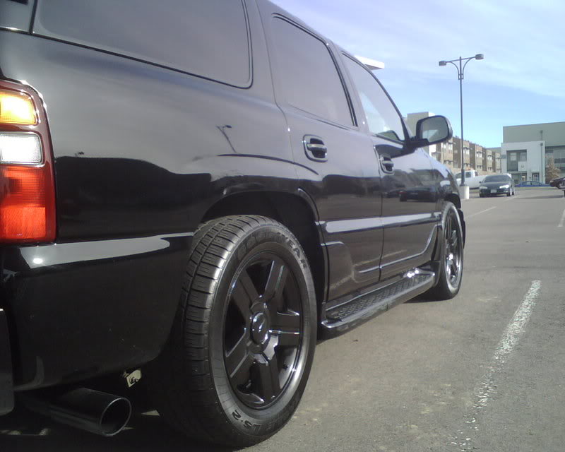

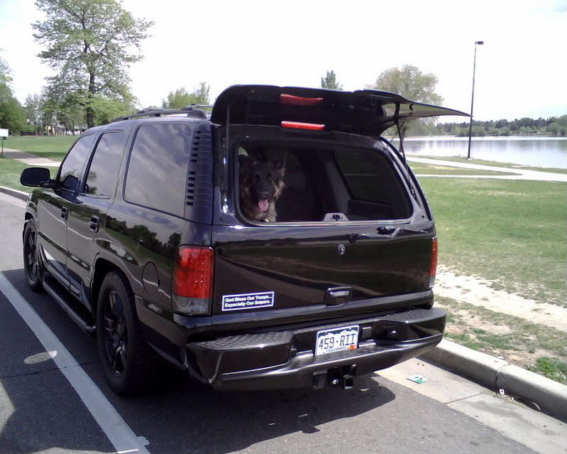

I had to build links for my denali after dropping it 3.5"f and 4.5"r. I just cut down some bolts of the same diameter of the links and threaded them down aways, I had to think of something quick because I snapped the little aluminum ones that came in the belltech kit. Even the shorter ones were giving me close to 1" of lift and the one side snapped so easily when I was grinding it that I just switched to steel. Here it is looking like a dragster:

And after a little work it sits way better:
