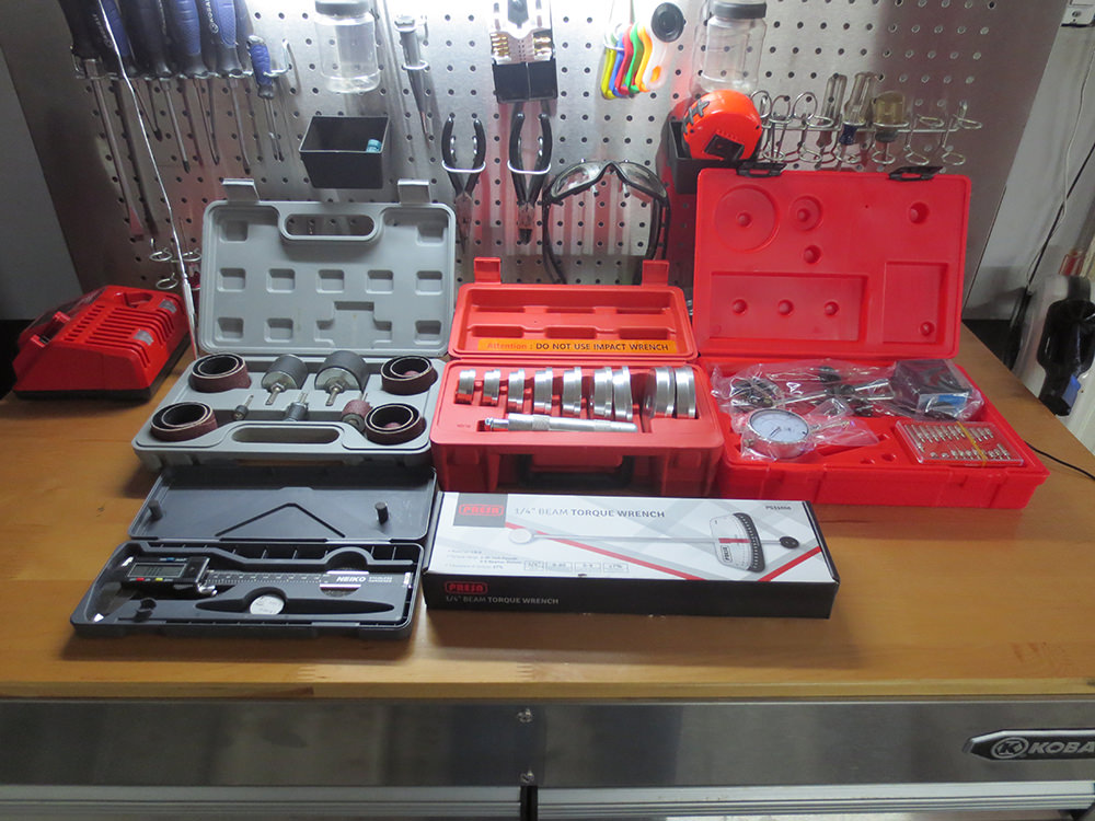

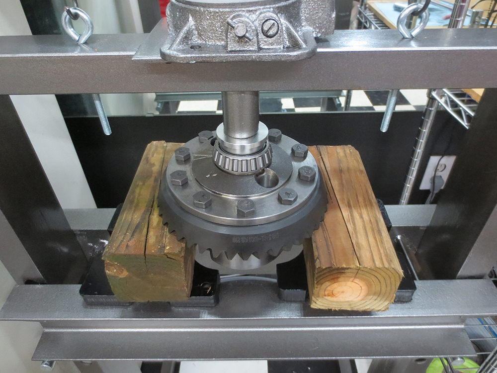

The most important thing is to get the rear of the vehicle high enough to work comfortable under... a lift makes the job so much easier. Using a crush sleeve eliminator kit is much easier than crushing those dammed sleeves lol. If using a crush sleeve you'll need to buy or fabricate a tool to hold the pinion during the crush. It helps to have a helper holding the pinion tool while you crush the sleeve especially if you're small in stature. With the eliminator kit you won't need a helping hand on the crush. Another plus using the solid bushing and shims (eliminator kit) is you can remove the pinion yoke and replace the seal without having to re-crush a new sleeve. Are you replacing the carrier and pinion bearings too?
Stuff I used:
Harbor Freight 6 Ton Stands
Harbor Freight 20 Ton Press
Cheap Pinion Holding Tool (ok for eliminator kit, needs a handle welded on for crush sleeve)
Assorted tools
This video explains the crush sleeve eliminator (helped me doing it the first time)
