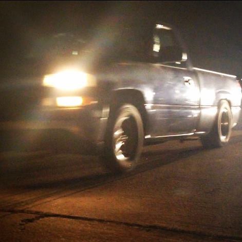

1" drop v6 springs on the street.

I've never driven anything w/drag shocks.
How are the 90/10s DDing?
Old Dec 8, 2014 | 12:48 PM
Joined: Sep 2003
Posts: 143
From: Idabel, OK
Thumbs up
It appears your setup is working well. Thanks for the info.

I have no sway bar.. In that that pic I just had some cheesy s10 shocks and only had 2" of extension.. I've since added a 9/1 7" stroke shock, rides just fine.
