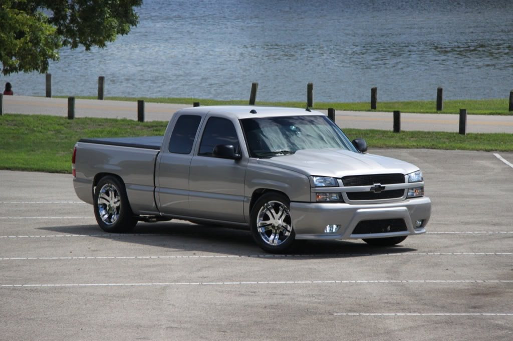

This is a 4/6 but it'll give you and idea. 05 Z71

Static54, what brand and how is it dropped? Im assuming spindles front?, Stock keys? What about the rear?
Bump for good thread! I wanna go lower too.

DJM Lower Control Arms and keys up front,
Lost the blocks in the rear and added lowering shackles and hangers as well as a anti sway bar.
The keys in the front I just ups to fine tune it, the ride quality is sporty not rough or crappy. You hit some bumps and you'll feel it but all in all it's definitely that sports feel.

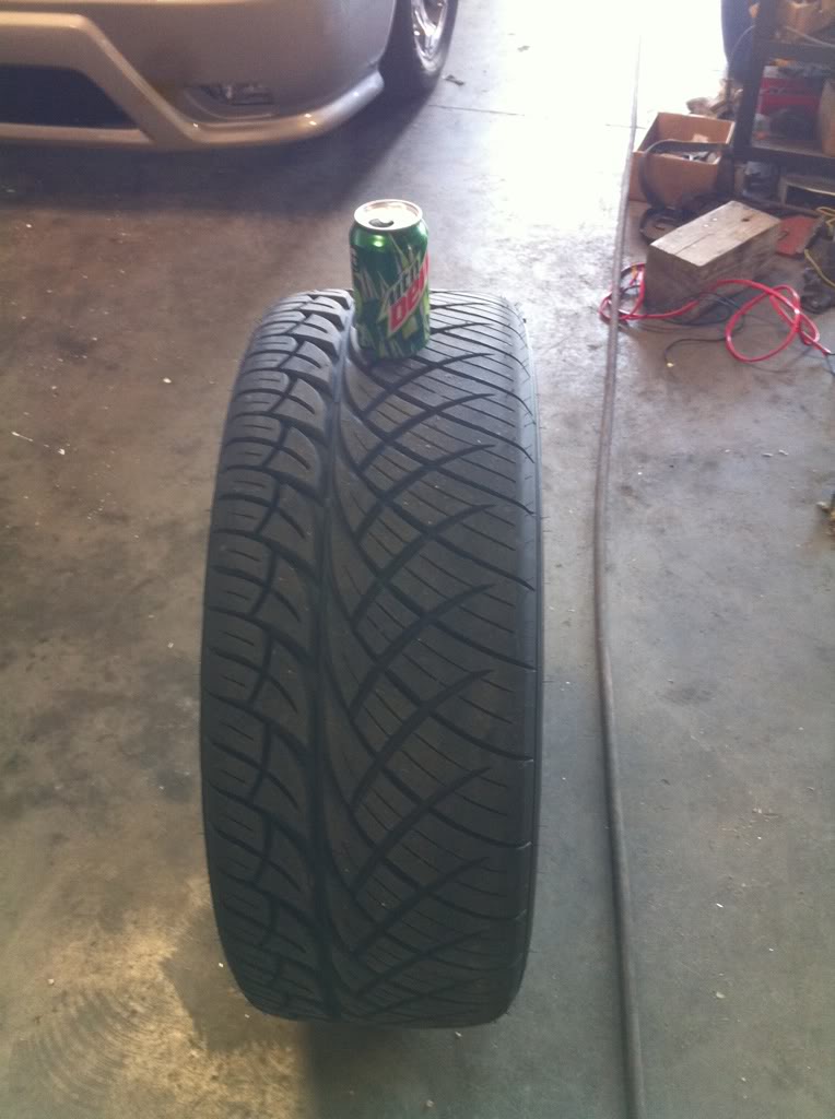

static54 what size tire did you have on those wheels in the pic? I am doing a 2/4 tomorrow on mine...its a 05 z. It currently has a 2 inch lift on the front and Im going to ride on the 2/4 drop until my control arms come in or I can find some used ones! Then I will lower it some more. I will be running 275/22

I run a 285/50/20. I get some occasional rubbing but nothing major.
