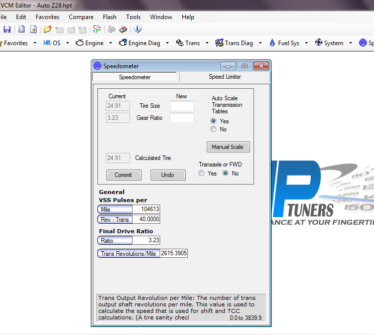

Also thought to pull two, bone stock F-body files from HPTuners repository. The attached screen shots show the speedo calibration section.
Note the Trans revolutions/mile on each (805 for manual vs 2615 for auto).
If you read the "note" about Trans Rev/mile, it says:
"This value is used to calculate the speed that is used for shift and TCC calculations."
Which may be why the F-body table is just pushed so far off. Since the manual cars obviously don't care about shift or TCC lockup, putting the output shaft RPM low might solve the problem.
I'm not sure if this will solve anything or not as I can't actually TRY my solution yet (tranny goes in 1st of June after classes are out). Perhaps someone else could take 5 mins and give these numbers a shot?
