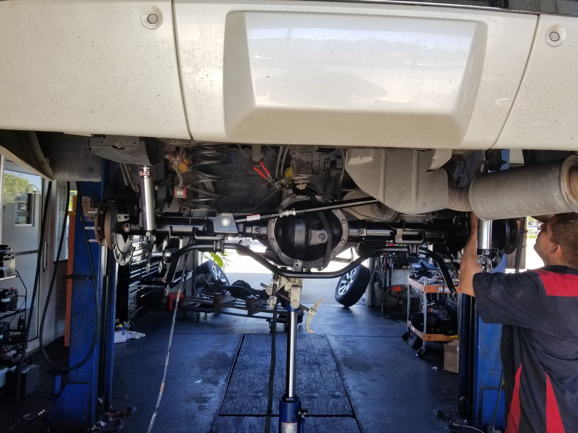

add one more installed 14 bolt.
my truck=2012 yukon denali awd (10 bolt)
donor truck=2013 cadi escalade 2wd
Direct swap:
-All links (4+panhard) bolted right back in place
-swapped rotors and calipers, only had to massage the brake lines over the pumpkin
-used the same universal joint and stock driveshaft, will probably get one built/balanced a 1/2" shorter but am able to use the stock length in the mean time.

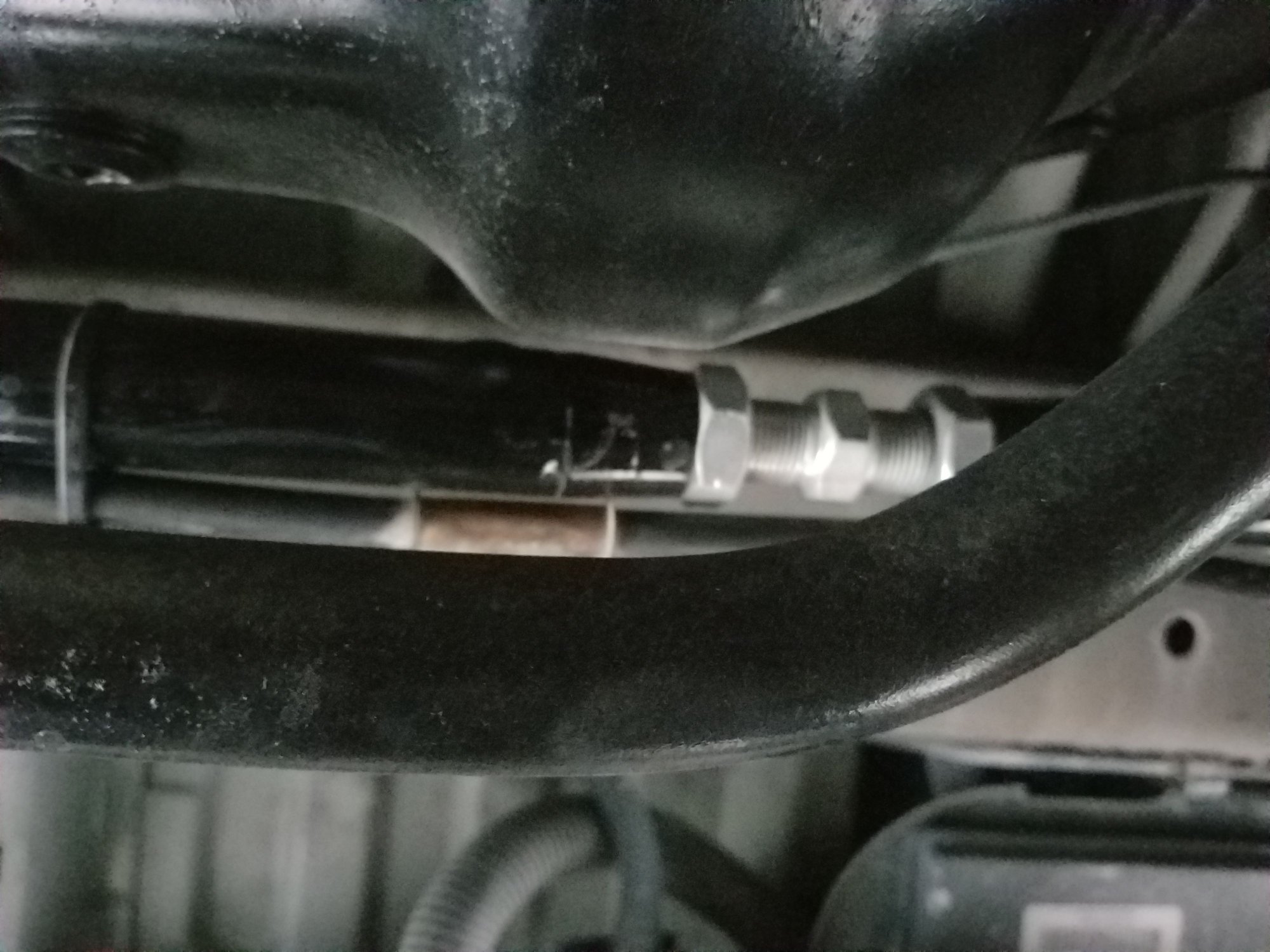

- stock 14bolt cover fits with spoon adjustable panhard bar (barely) i have the lowest profile PML cover i'm going to try and put on, but i think i will have to lose the adjustable bar. Or more of a drop pulls the rear axle forward and may allow it.
Well well well fancy meeting you here lol... I was about to ask about the "barely" clearance of the Spohn panhard with the factory cover on my new (to me) 14 bolt swap, then I saw your screen name and realized that I'm pretty sure I've already read the answer in your build thread over on the Tah/Yuk forum. I've been dragging my feet on completing this swap over whether to disturb the pinion or not? Would be so much easier to leave it alone and just install the Truetrac and call it a day......but then every noise I heard back there would have me thinking the pinion bearings were goin out? Anyway, just wanted say whattup once I saw who it was lol... Take care bro
One more question: Any issues with driveshaft due to the extra 1/2" length on 14 bolt now that you've got some miles on it?
