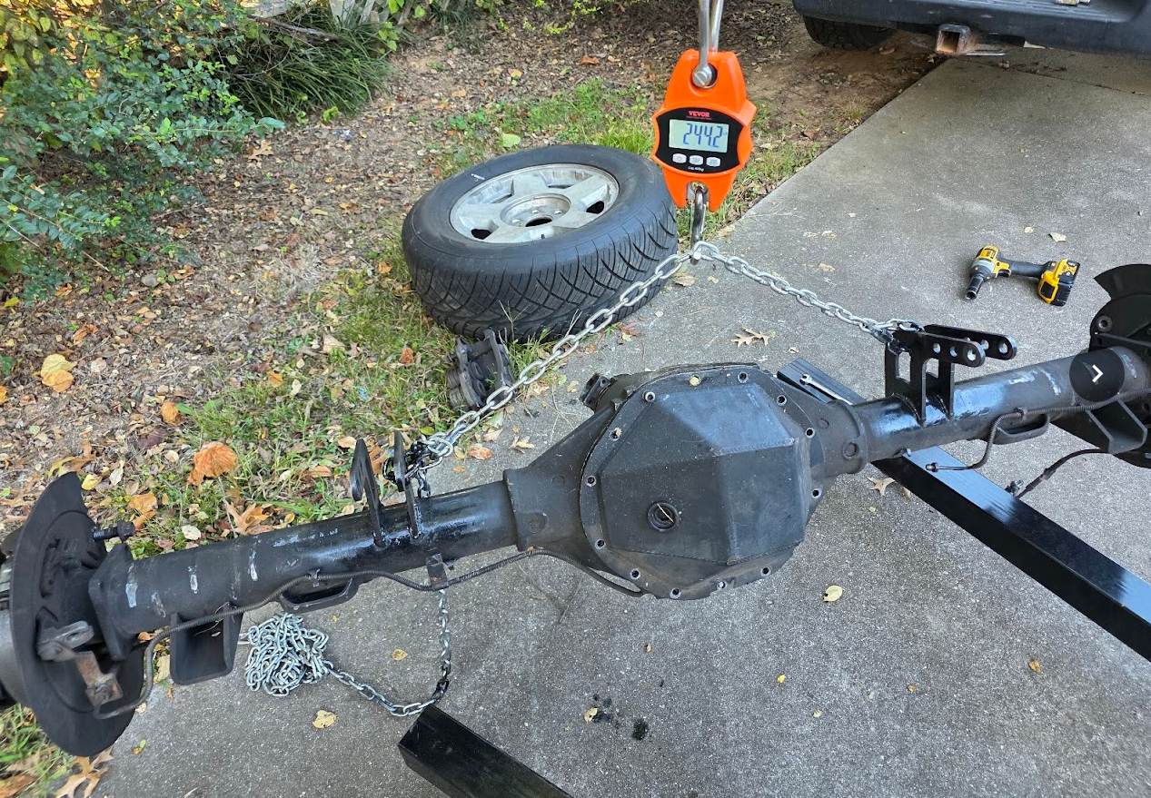

My OBS 14b 9.5SF with a heavy duty cover and no brake rotors or calipers weighs 244lb for anyone interested. It is lighter than I thought.
