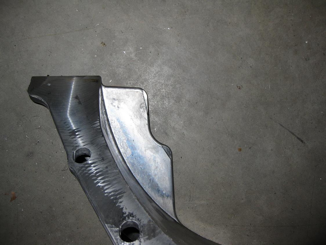

The TCI 753 is for 60E style converters- 3 bolt, long snout- which you have on your PI. All TCI plates are flat, but they have spacers welded at the bolt holes, so the converter ends up the same position as with the dished OE plate. Might have to clearance the 80E dust cover a little for the heads of the converter bolts though. Had to do that when I used that plate.
Attached Thumbnails Need a replacement flex plate/ Flywheel 60E-img_0567.jpg   Need a replacement flex plate/ Flywheel 60E-img_0568.jpg
