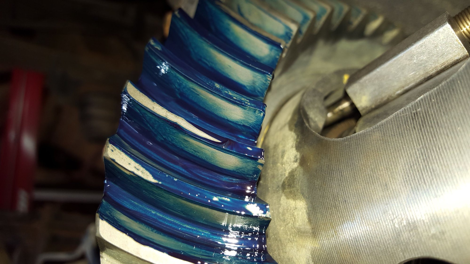

Need a inspection on my first gearset wear pattern

Yeah didnt seem to move it at all actauly.
Im curious how it would change if you tightened backlash a little bit with the 25th shim in it.

I am now at a .028 pinion shim with .003-.004 backlash

Based on the pics i would run with that

Here was the finial assembly settled at .004-5 backspacing was right in the middle

Just drove it was nice and quiet thanks for the help

It's the factory G80 limited slip differential it's in a 05 Silverado z71
