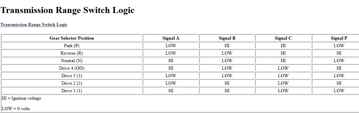

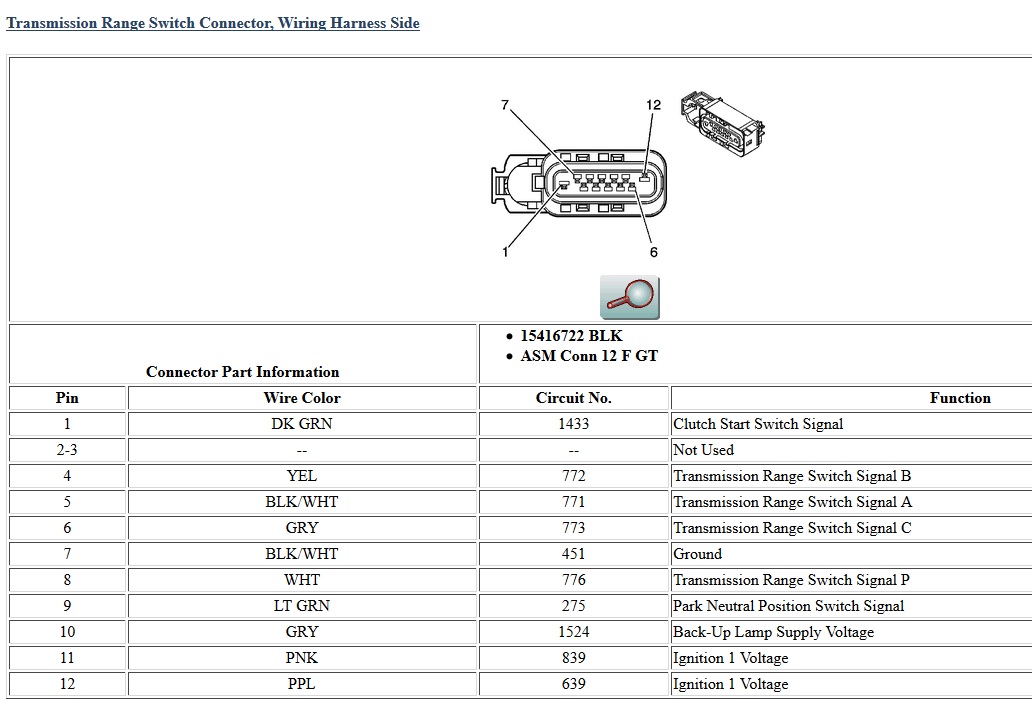

Range switch:
Attached Thumbnails gear indication-range-switch.jpg   gear indication-range-switch-2.jpg

hey thanks for that really helps. now I just need to figure out a way to get it to work together.

Think I am going to put a 1" OLED in my dash beside the Holley digital dash for a shifter position indicator. Will wire the range switch to a small circuit board that controls the OLED.

I will just build one.

I added some clarification of the circuit functions
