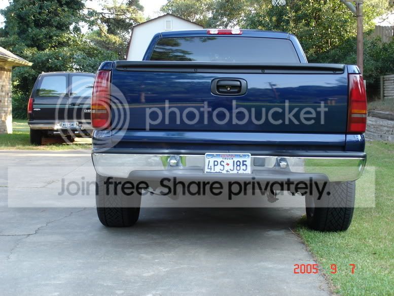

I dont think mine are too bling. Gets just enough attention for people to say they look nice but no so much that they want to steal them. They are Ion wheels, 18x10 with 275/60 and 0 offset(which i believe is 5.5inch backspacing). Had to tie the plastic part of the fenderwells in the front(with zip ties) back about 1/2 inch to keep from rubbing when suspension is compressed. Im not a big fan of 20's but i wanted a 10in rim so i went with 18's.

They look pretty nice I must say. You have Falkens correct?? 275s you say, they look wider than my 285s because you have the correct rim width and I do not. Looks great.
