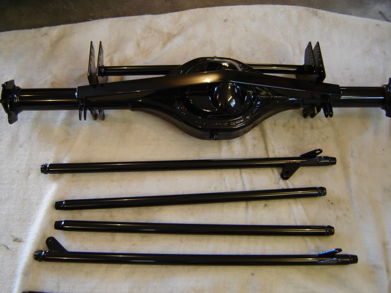

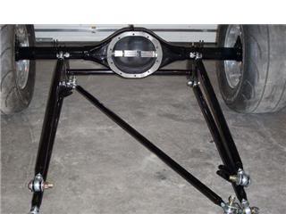

Sorry to hear about your luck with Moser.
This is the one that you needed

thats nice, Thats what Im getting.

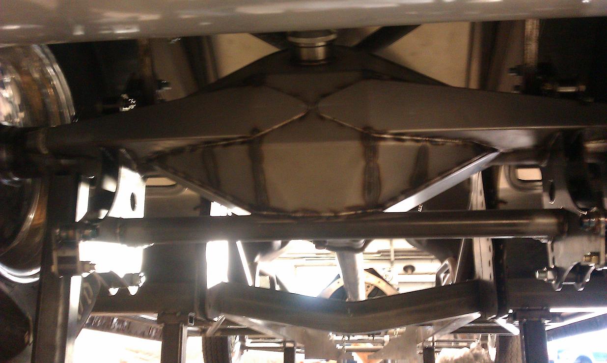

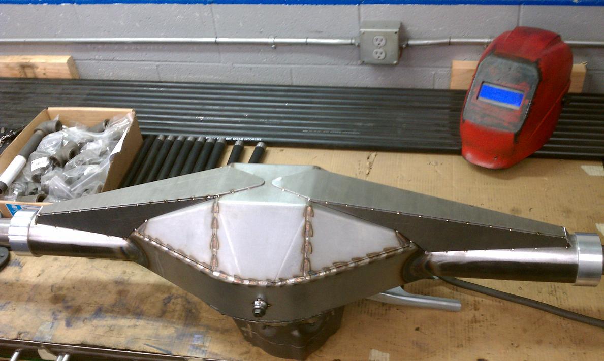

The problem with the factory housings is that the Face were the pumpkin bolts up will deflect and cause excessive spline wear with out additional internal modifications. Personally with the time it takes to modify the stock housings by re- tubing it and adding internal gussets its easier to buy something like the Bare strange fabricated housing and build something off of that.
I used the H1112 for my race car and got it with the back cap loose. I always get the tubing locally and TIG weld it in for a cleaner look. I then made a sheet metal back cap for it. I also used MARK WILLIAMS for the axles and the assembled 3rd member. The strange 3rd member in the pictures is just for mock up so I can roll it around.
