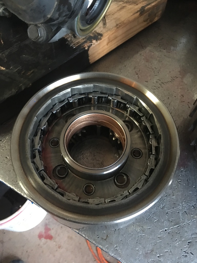

Well I'm assuming I found it.. The low roller clutch looked good. I don't think you can install it upside down in the early model cores. And all the rollers were in place.. So I scratched my head for a quick second and this came to me..:
Why am I not seeing anyone else installing this center support snap ring around the spring assembly? Do I have it installed wrong or so the 97-up 4L80es not use it??
Been looking through threads and videos and I just see people installing the spring Assembly without the ring around it.
And this...
Good pics guys. The ASTG manual shows the ring that I have in their pics but it doesn't show how it is installed. I assembled the center support without the ring like you guys have pictured. I can't find any images or videos of how it should be installed... Think it will bite me in the *** later down the road?
I will have to give a few shops around town a call about it.

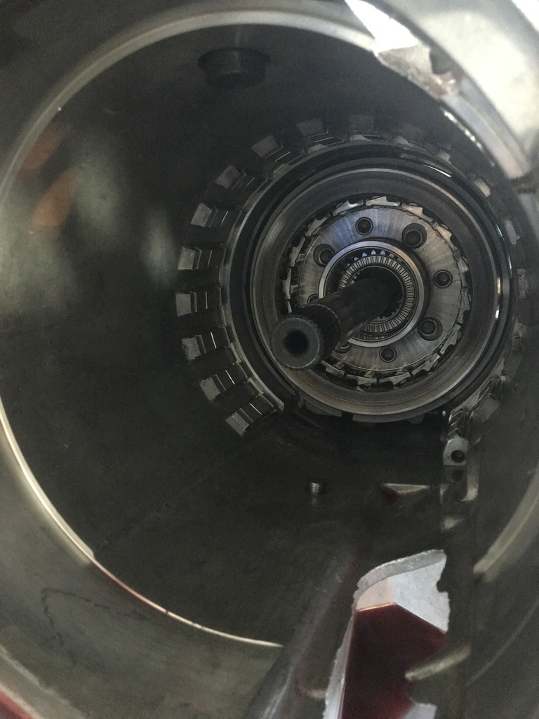

So here is what it looked like when I pulled the reaction carrier. I noticed the low roller clutch was sitting pretty deep in the grooves. Keep in mind I don't have anything that has shown me it needed to sit higher, it just looked funny now that I figured the low roller was giving me my first gear issues.. So it popped in my head that I have been trying to figure out WTF that spacer ring was for.. Slipped right in to the reaction carrier and with the low roller installed on top of that, it sits right in the middle of the grooves.. So I'm pretty confident that was the issue. I have the early model core so this roller doesn't have the feet on the bottom of it. So that spacer must have to be in place to keep the low roller clutch from sitting too low in the bore and missing the center support..?

Without the spacer below the roller:
