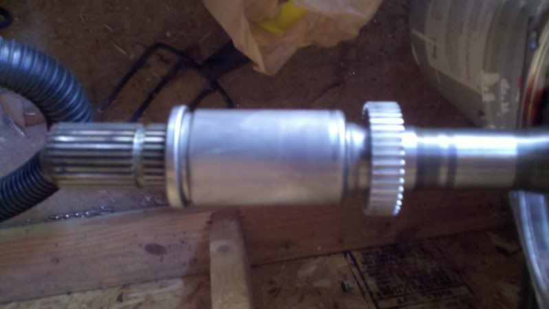

Originally Posted by Vince B
The quick fix here is to seal up the back of the yoke if in fact that is where the fluid is coming from. Vince
hmm... looks like i did something right for a change
Old May 26, 2011 | 08:50 PM
slowec's Avatar
Joined: Jun 2004
Posts: 3,062
From: Brunswick, Ga
The guru was dead on. This device behind the speedometer ring was left out of the build. Took it off my old trans and put it on and now she is good to sit and wait for Friday nights.

Posts: 8,688
From: Bloomingdale Illinois
Glad to be of service!
