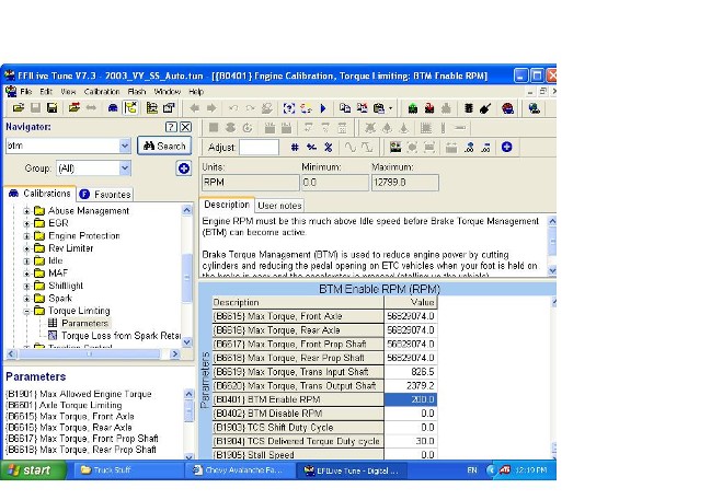

Make sure that "Brake Torque Management" is also disabled in your tune. BTM reduces engine power on ETC vehicles when your foot is held on the brake.
