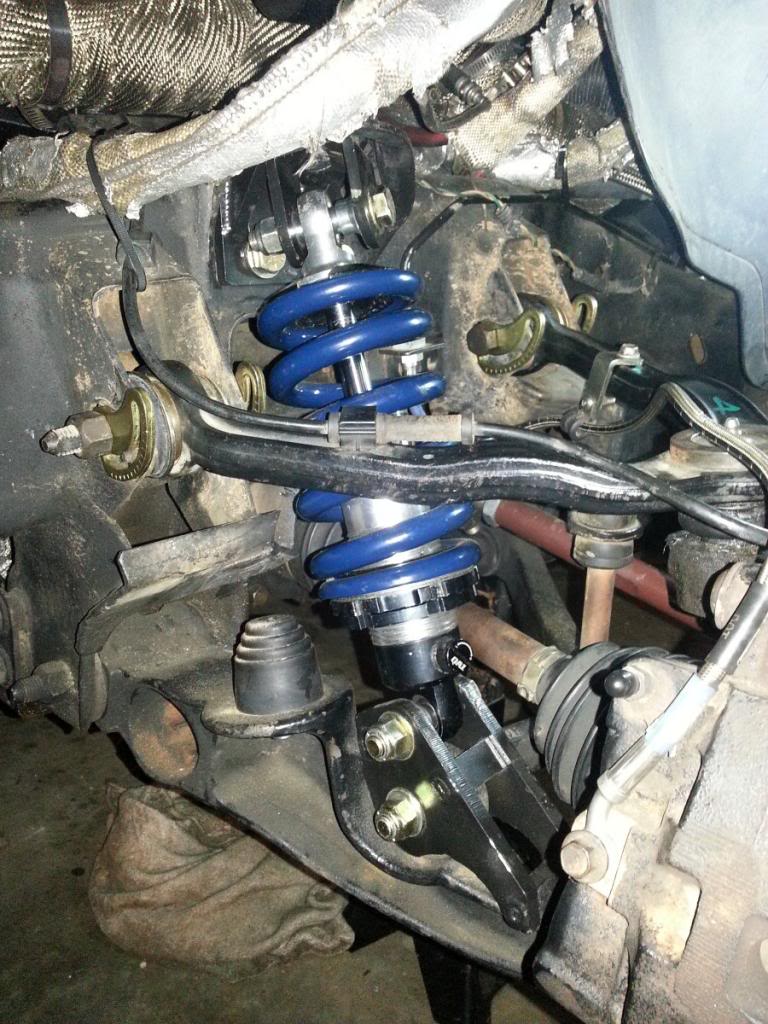

Or you could do this and get rid of the torsion bar and jounce bumper completely and lower it however much you want
(shamless plug, see the links in my sig for details)
I expected this..........lol
