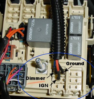

I hooked into the Relay control box, or whatever its called. It's located on the front floorboard on the left. There's lots of empty connections down there for me that can be made useful.

I took a look at that relay box, it seems that my box is setup differently than yours. However, I think I found some connections in that box that I can use.

On your picture, you point out the dimmer. So does that work on the backlighting when you use the pannel dimmer control?
Yes, it does. It is the dimmer circuit.
