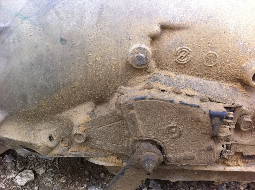

I was reading on past threads about putting the temp probe in the pressure port on the tranny an it'll thread right in, but where is the pressure port on a 4l60e?
It's the pipe plug just above the PRNDL switch.
Old Sep 20, 2011 | 12:56 PM
Steve-O-08's Avatar
Joined: Oct 2009
Posts: 991
From: West Jordan, UT
Yup, that's the spot. Have mine in the same port.

Holy dirty transmission batman! hahaha Im glad i never take any of my trucks offroad, i would hate to have been the one who pulled that trans out!
That port will work just fine, some guys even get a bung welded to the pan. Thats how john used to have his on his old truck...

can i get to that without dropping the trans? any zoomed out pics btw? i have no idea where that is in the trans...only work ive done on tranny's is installing servos lol

You should be able to snake your hand up there to thread it in

looks like the left side of the tranny?

and this is the port, right?
