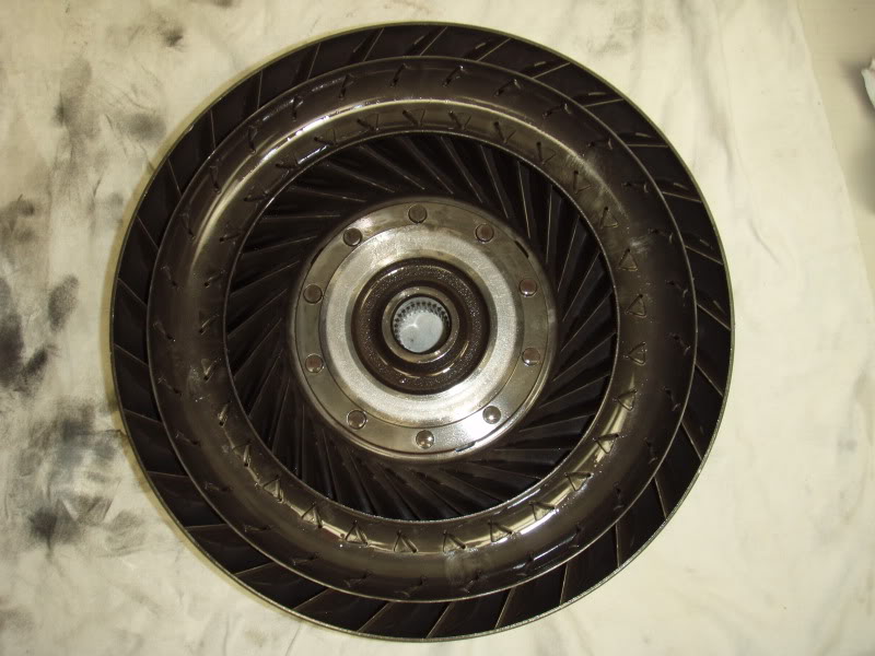

Hello Fellas
It's been a long time since I've posted here.
I basically just got my truck to a fun level and left it alone for a few years.
103,000 miles on it now, and the trans finally decided it wanted a rebuild.
At about 30K I put in a vette servo and HD2 kit and it's been performing well until last week. It started slipping on the highway and less than 15 miles later, it would barely move. We have it torn down now and are putting all of the basic internal upgrades.

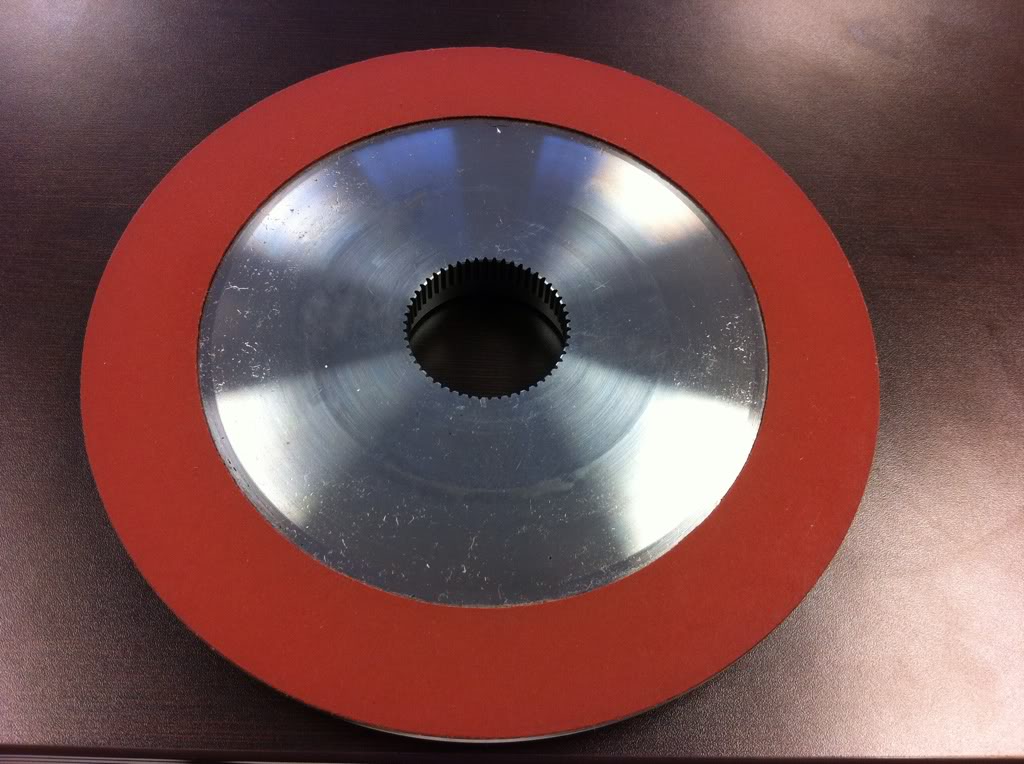

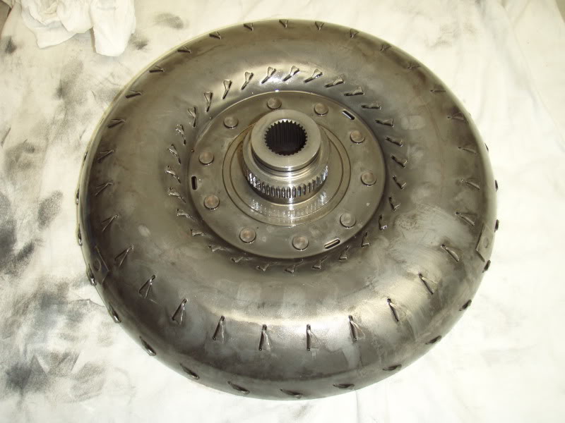

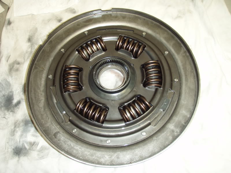

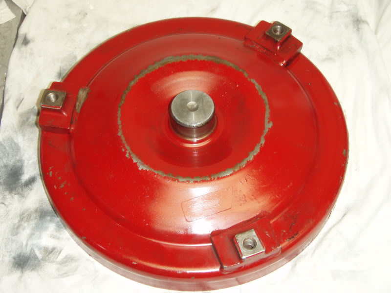

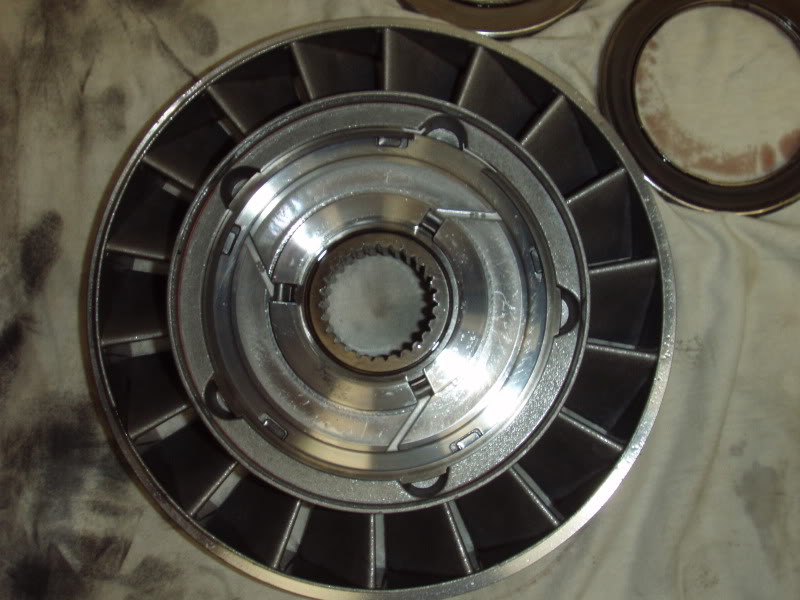

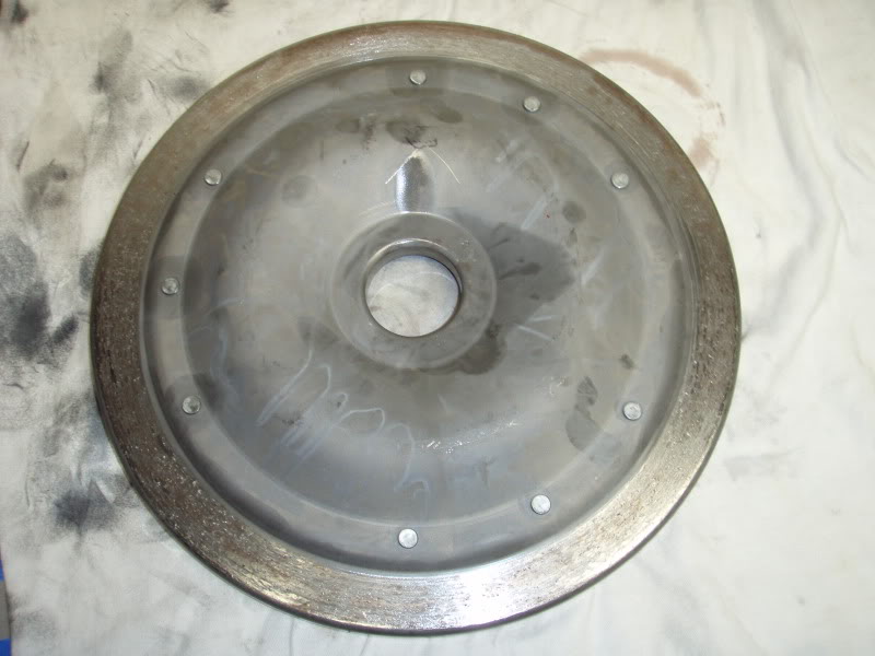

I had my TT2600 cut open at a local converter shop to check it out and hopefully just do a cut/clean and then install it again. I believe that I have about 60k on the converter.

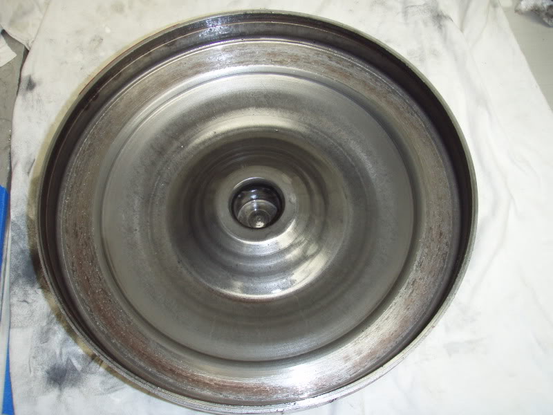

When they got it open, the clutch lining was completely gone.
I will be getting a fresh converter to replace this.
This converter worked well for me until it died. I have towed and hauled tons of firewood, snowmobiles, boats, cars, etc over the years. Been down the track several times.
This converter has also been through several WOT lock ups in 3rd gear before I changed the tuning.
The owner of the converter shop says that it looks a lot like a stock converter inside.

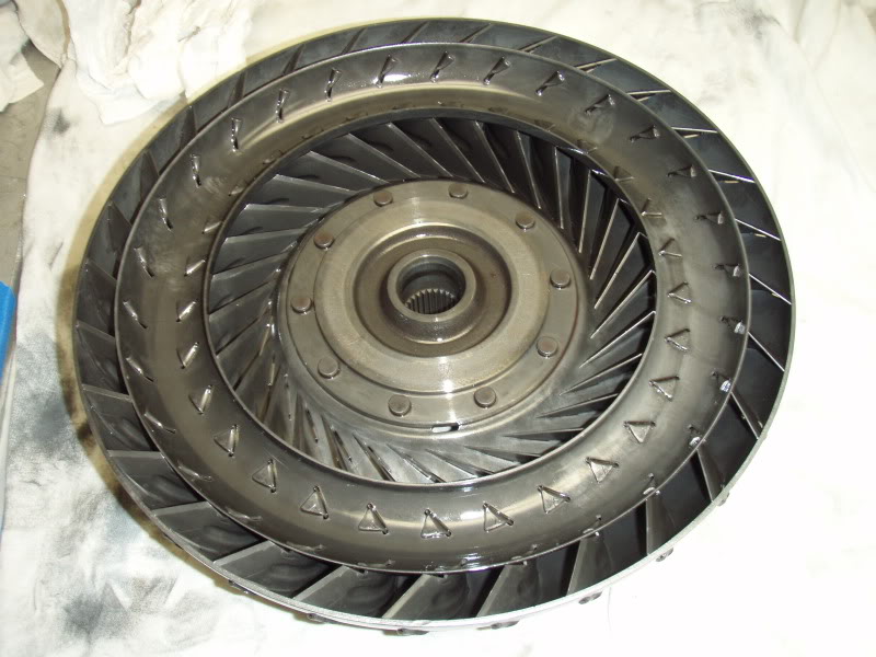

I am not qualified to analyze whether the parts are stock or not, but wanted to share the pics with you guys and just see what you think of it.

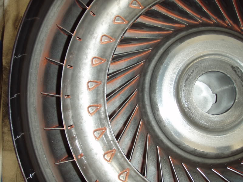

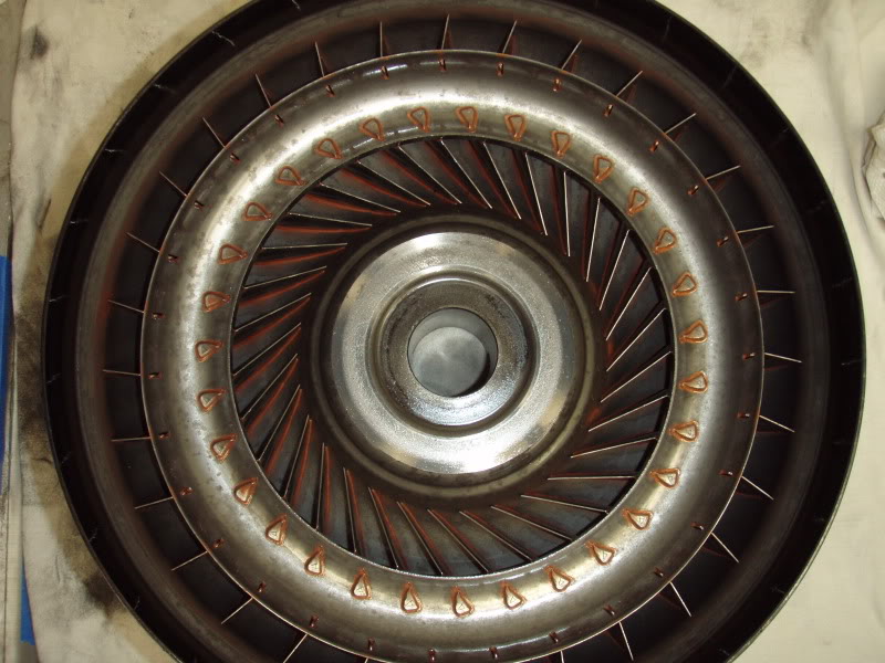

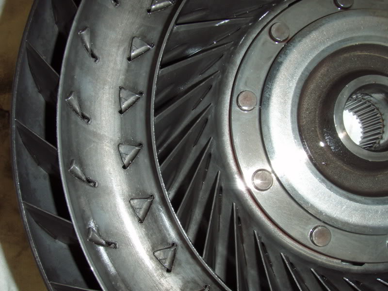

I do see that one half of this thing is not brazed and am wondering why.

True about whats inside. Its like VOODO to the average guy. I know these things are not cheap either. So it is nice to see what exactally your paying for. Unfortunately most people would not know the difference.
Any chance your guy could cut a stock one open so we could see the difference??? I know these are supposed to be more efficient.
This is our lowest price entry level converter at $475.00, the turbine is not brazed as in our our highter priced converters.
As a Note: large dia. turbines have a high rate of warpare during the brazing process due to the thin material the factory uses, warped turbine loose performance.
The clutch is not designed to lock up under load or WOT as the clutch lining is a wear material as the OEM tuning must allow for smooth engagement and release.
The time 6 years and your usage and conditions is very good, but you might look at an upgrade to a true performance converter with a billet cover and clutch assembly.
Thanks for the update on our product performance.
Yank
Yank

I am not an expert by any means. But he did say he had WOT lock ups in 3rd gear and towed a bunch of heavy stuff. That kind of stuff can be hard on a converter. If the trans was failing as well, that could have aided in it's demise.
The reason I ask about maintenance is because the filter start to clog and become restricted. You won't notice it until its to late. Once the filter loses its ability to properly filter contaminates the finer contaminates start getting by the filter.
By pulling the pan and changing the filter, you can see if you have excessive build up in the pan. If it starts looking bad you can get into before it becomes catastrophic.
When we modify what the transmission was originally designed to handle then we need to modify our maintenance plan to help protect it. A stall converter is essentially slipping until it becomes fully engaged. As you raise the amount it slips and increase the power and now you start needing to do the maintenance more often.
