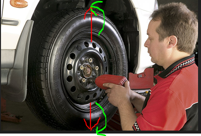

isnt' the up down motion a ball joint diagnosis? maybe im not thinking the right up down?
red or green path?

Yes and no. Your looking for both. 12 and 6 is the best way. you can get a false positive at 3 and 9 as there will likely be a small amount of play in the steering.
