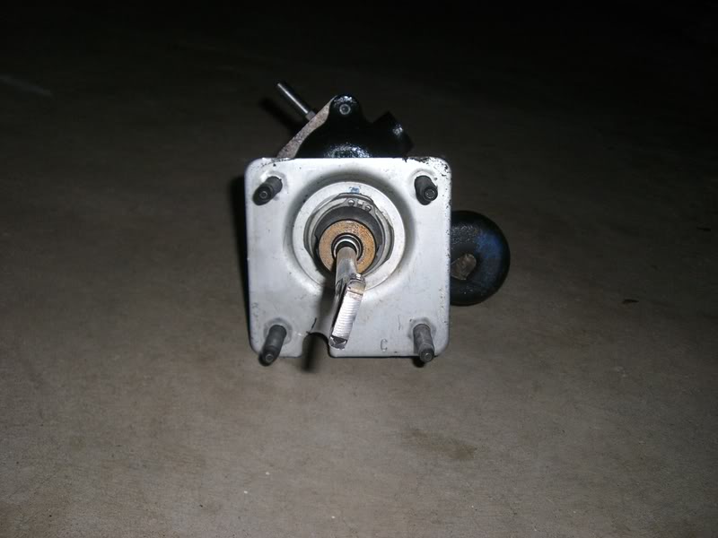

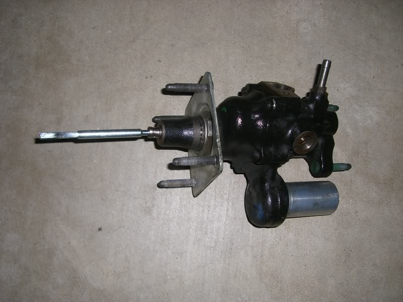

I just got in my hydroboost unit. I bought it on ebay. Check out the bolt placement. You think this was off of a denali or similar instead of a HD truck?
Or is it older?

The HD trucks have the "odd" bolt pattern. Not a perfect square. It very well could be off a Denali, Escalade, or Hummer.
GL with the install.

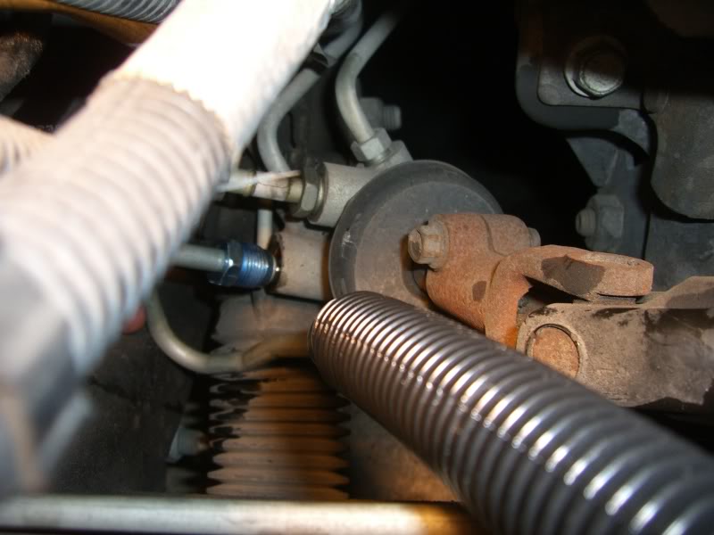

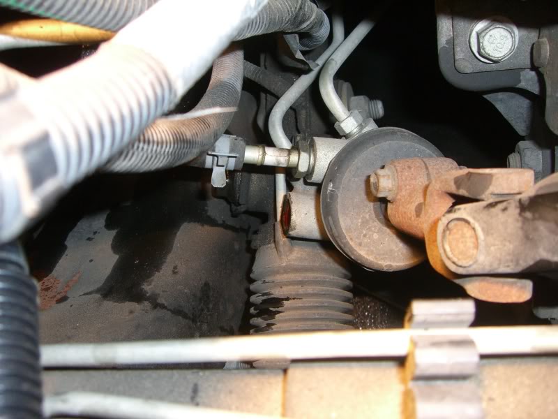

Here's a picture of the frame/rubber boot interference I'm getting
Attached Thumbnails Hydroboost Conversion Install-cimg1248.jpg   Hydroboost Conversion Install-cimg1249.jpg

Try flipping the hose..
IIRC that end goes to the Booster not the Steering box.

Well, I've been using my dad's 1500HD as a pattern truck. He's 4X4 and HD so he has a diff steering system than me. Might just have to bend these. Any tips to do it without collasping/kinking the line?
