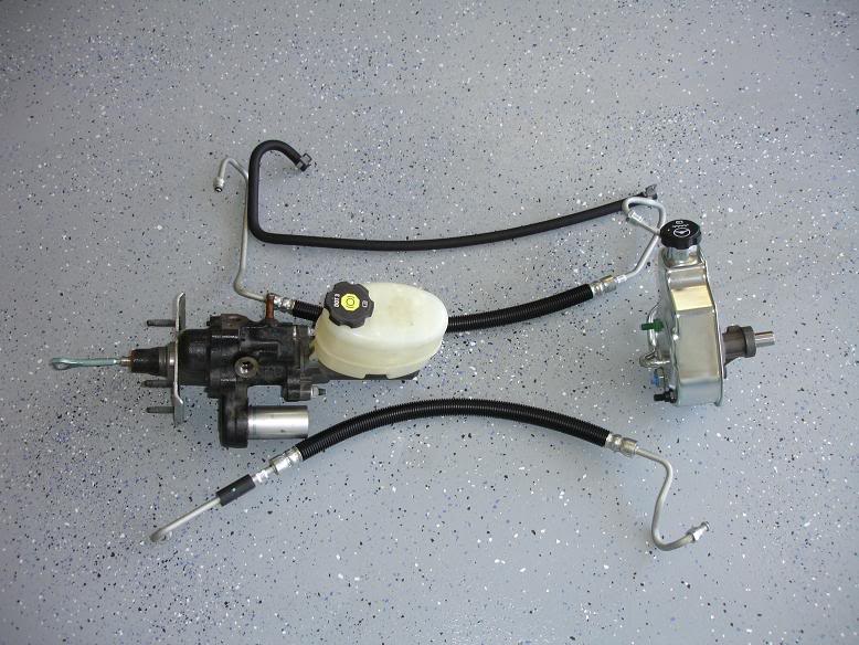

The rod in your booster does appear to be longer than the one I installed. Mine had the offset bolt pattern
