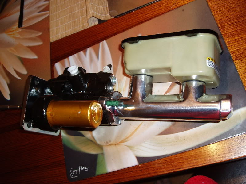

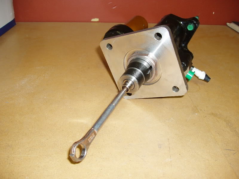

I bought a brand new unit from evilbay for $275.00.
The MC cost $110.
I had to make a new mounting plate to suit the slightly different pedal position.
I mounted mine upside down to hide the hoses.
That clip...put a flat bladed screwdriver in the 'key hole' type slot and turn the screwdriver 90o to spread it. Slide the clip off.
