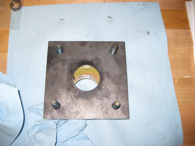

Originally Posted by 2004SSS
http://cgi.ebay.com/ebaymotors/Astro...Q5fAccessories
is this the one your speaking of? is anyone able to confirm the mounting holes ? i dont have my truck here or apart to look at . i can drill new hole but if these will work i may just use it.
Thats the one. I bought this plate and it lines up perfectly with the stock HB plate mounting holes (this is for a HB of a 98 HD truck). The thread Howard posted from pacificp if my setup that I have ready to install. The only thing I had to do to the plate is file the key a tiny bit and paint it.
The stock HB plate is underneath the ebay plate and as you can see it fits over without any problem.
