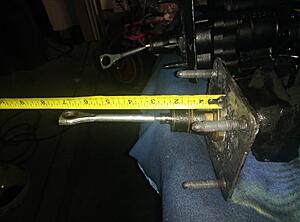

So finished up the swap. Turns out the express hydroboost rod is about 1⅛" longer. The pedal was about 2 inches shorter than the emergancy pedal. Ended up having to grab a reman unit from O'Reillys. It all bolted right up to my rack and pinion steering. Having the crow foot wrenches in 16mm and 18mm helped immensely. Took some pics of the difference between the van hydroboost (silver accumulator) and the Silverado hydroboost (black accumulator).
Imgur link

Interesting. My Yukon has a unit like the silver one from the van.

The black reservoir is fron the reman process when the paint them... Usually oe theyre silver or a brass looking color
